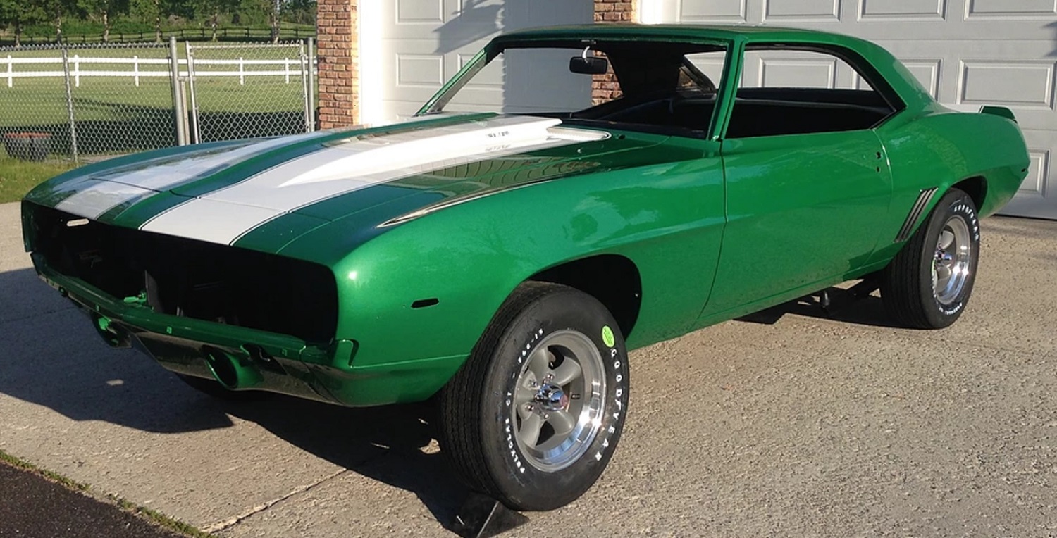

Here are some TTOs 15" x 7" in std offsets.

That is one good looking Rallye Green car Stefano. Is it your's? The white one, too.... Jack Douglas car? Not intending to hijack the thread, just giving credit when due.

The RG COPO is NicKey Continuation Carmaro #002. We sold it while back. The Jack Doulass Yenko is on consignment with us.

Wow! Now that is the look I am after!
Can someone tell me the part # for these or the offset? There seems to be a ton of sizes and offsets to choose from. So with 15x7's what is about the widest bias ply I can put at all 4 corners? My second choice would be to put something a little wider in the back like possibly an E60. First choice being the same size all the way around.
