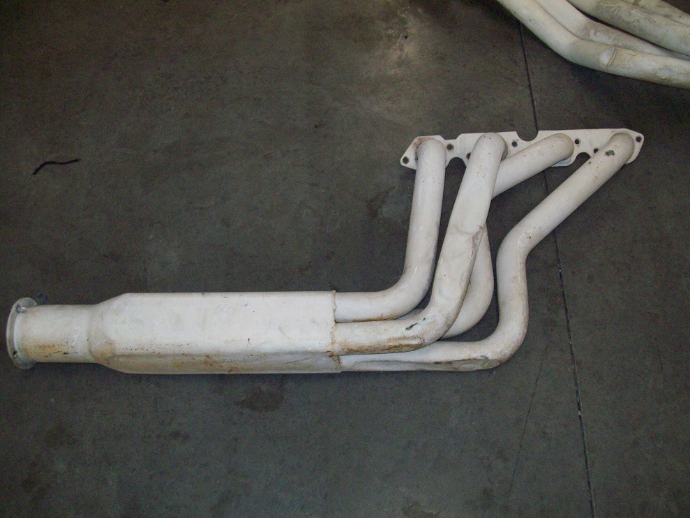

Has anyone ever used these headers or know how they work, supposed to be circa 1970 Mickey Thopson Super Scavenger Repoduction Headers. They claim they "The main tubes are all of equal length with them being staggered as they emptied into the massive collectors that thumped out that unique Super Scavenger sound.

The pipes were/are equal length but they were able to achieve a pretty typical looking primary tube routing by stuffing all the 'extra' length inside the boxed collector.

Would not worry to much about exact equal length if they are mainly going to be corked up on the street.

Manufactered &amp; Marketed through 1973. By 74, these were obsolete. The low performance was the big issue along with cost......These Came Out the Box ORANGE in color. (These weren't found on serious Street cars or Street-n-Strip cars).... CRAGAR had Orange headers a 1/2 decade before M/T.
Bill Thomas had Blue, others had various 'FAD' colors as well.
The info pictured is from an original 1972 Holley Mickey Thompson Catalog.
