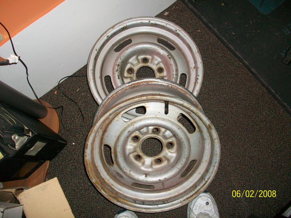

1 pair of 15x6 rally wheels DC code 250.00

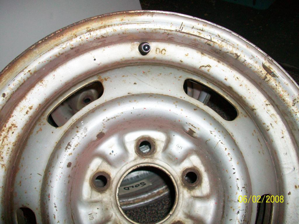

Large DC or small DC stamp? What is the date? If they're '68 dates, the date will be by the valve stem hole. If memory serves me correct, the '67 dates are on the wheel bead.

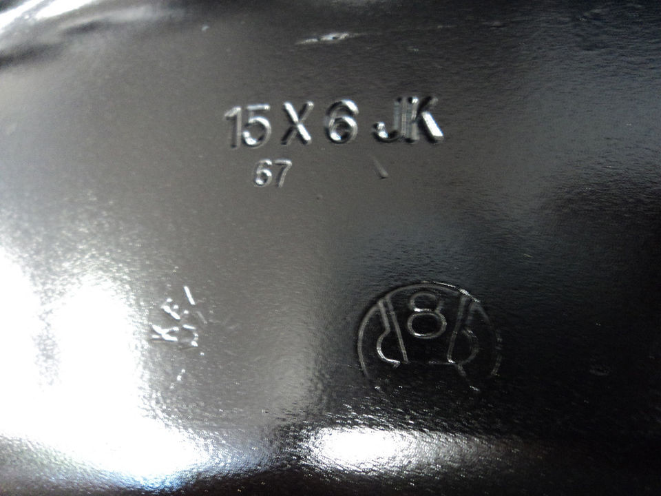

On 67 wheels i have seen it is by the stamped rim size on the inside of rim
so tire will have to be unmounted to see. This one is 67 1

They are the large DC wheels with no date. That's why I think they are 67 wheels. There are no tires on them so I will check to see if 67 is on the inside today. I will post what I find.

I could not find any stamp on the inside of the rim.

According to Alan Colvin's "1965-69 Chevrolet by the Numbers" book ( pages 320-321) 15x6 coded DC rally wheels were correct from 1967 thru 1969. It was used on passenger cars as well as the Corvette. Hope this helps.

heres a pic
