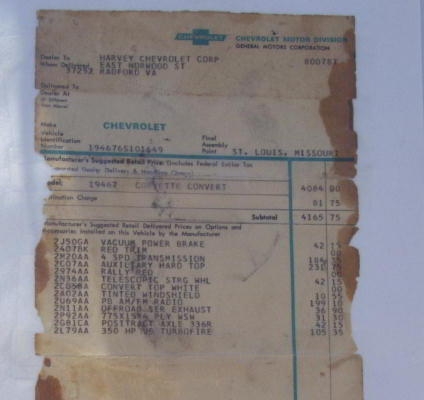

I noticed that on the window sticker as well - fully typed vin. Here is a good window sticker:

That is a nicely equipped L89 Camaro! I have noticed how popular, in 69 anyway, that door edge guards were for Chevelles too.
