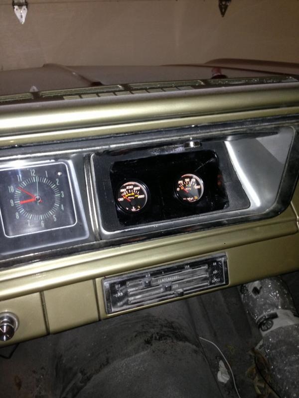

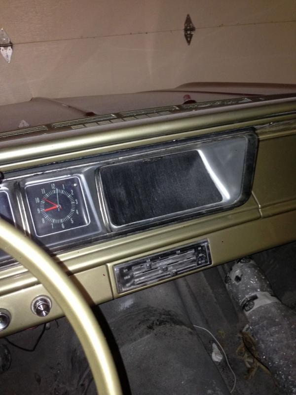

The restoration on this Biscayne is underway. It was originally an Aztec Bronze/Fawn 6-cyl car. It is going to be a 427 replica when it's done. The car was purchased with a 350 in place of the 6-cyl along with a TH400 and a 12 bolt 4.10 Richmond Posi. The 350 was sold right away and a '73 LS4 454 was purchased. The engine already had 11.25:1 LS6 forged pistons and forged rods. An NOS LS6 crank was purchased as well as a Lunati roller cam, stud girdles, 4 bolt mains for the conversion, roller rockers and 950 HP Holley Carb. The idea for this car is simple, as stock looking as possible but run 11's in the quarter.

This is what I am shooting for when it's done. Currently the front clip is removed and down to bare metal and the front suspension is removed getting rebuilt and repainted. The front frame and firewall is down to bare metal waiting for paint. I will post more as progress comes.
