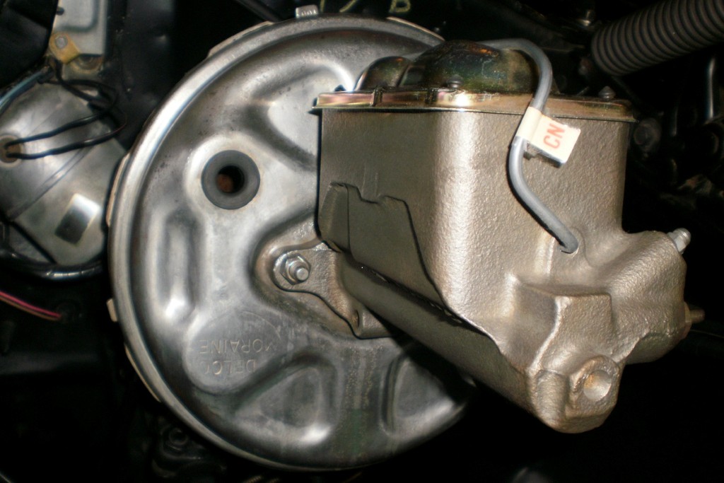

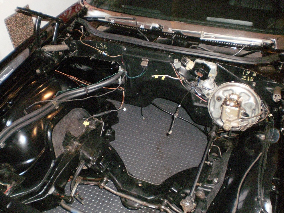

First Off is the Engine bay without the Motor.
If you spot anything that does not jive, let me know.
The Brake booster has never been off the car so it stays as a survivor part with it's faded silver color (i know it should be Gold Cad plated).
The Windshield Washer Motor also seems to be a survivor so i will also leave that alone.
Wires just needed a good clean up and there were no splits or rewired pieces to be found (only had to ad a new wiring connection for the -Negative wire for the Tach Brown wire that goes to the coil as the other Connection plug was hooked up for the former HEI ignition system.
Original Brake lines were polished with a wire brush and then sprayed with Krown T40 protection.
Old 11-28-2011, 12:31 AM
John Brown's Avatar
Location: South Bend, Indiana
Posts: 2,820
Thanks: 455
Default Re: 1970 Chevelle SS 454 LS6 Rebuild + Details
<div class="ubbcode-block"><div class="ubbcode-header">Originally Posted By: XXXBlackLs6M22</div><div class="ubbcode-body">
.....The Brake booster has never been off the car so it stays as a survivor part with it's faded silver color (<span style="font-weight: bold">i know it should be Gold Cad plated</span>).</div></div>
I've seen pictures of new cars delivered with silver brake boosters.... they were on Nova and Camaro though, so Chevelle may be different.
John Brown

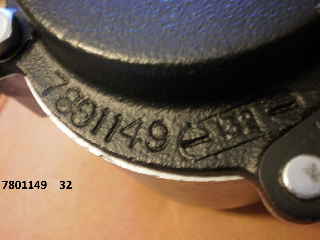

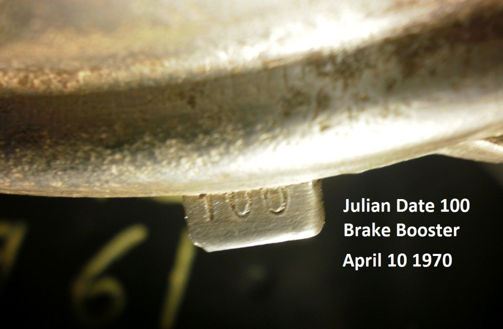

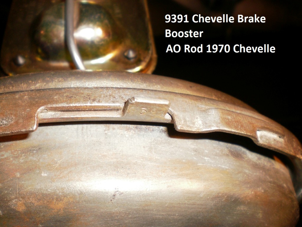

Here are some close up details of the Brake Booster with Part#/Julian Date and upside down Delco Moraine logo.
Car's final assembly date was April 23 1970 as per Build Sheet.

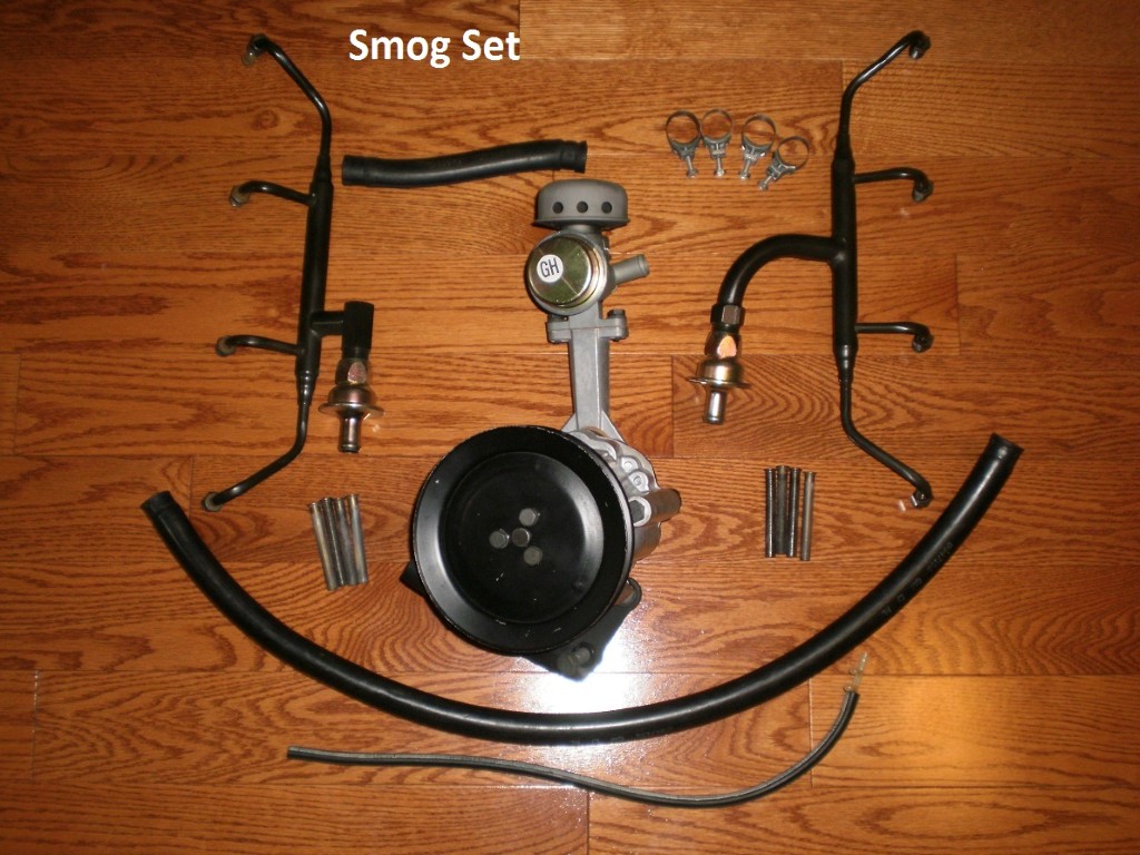

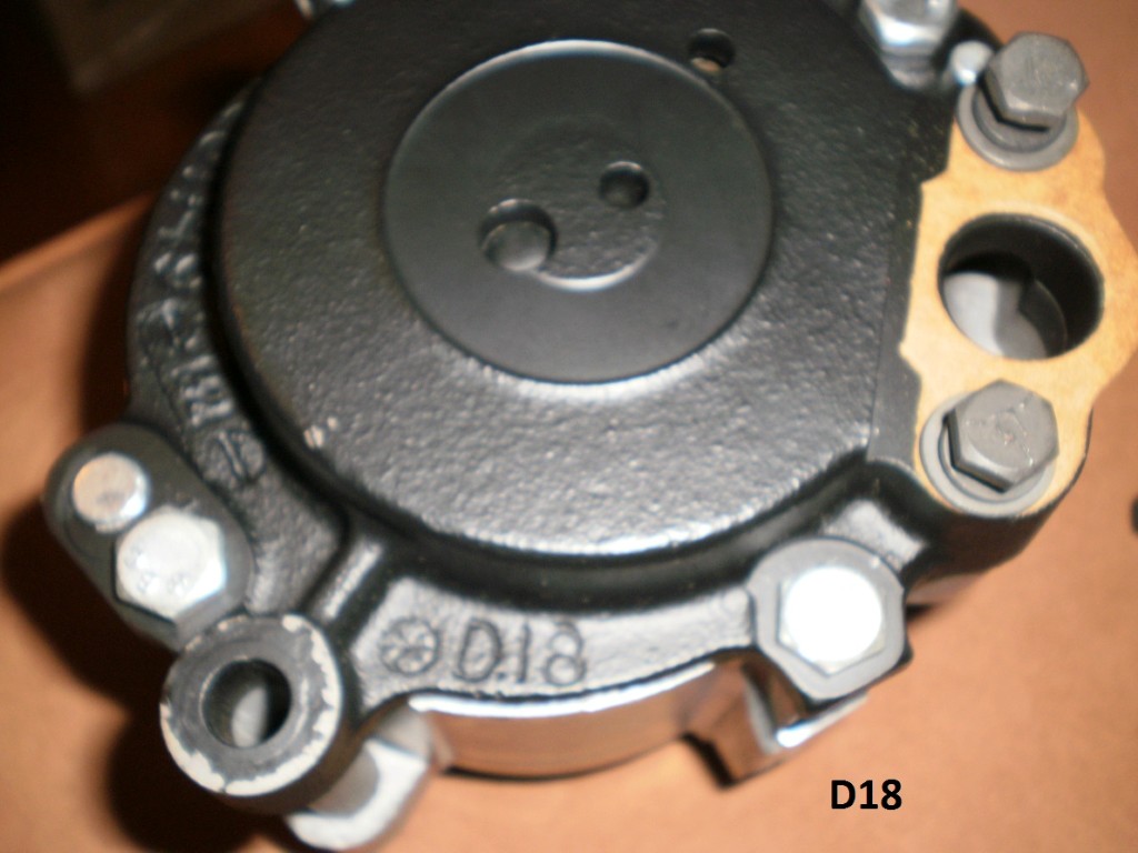

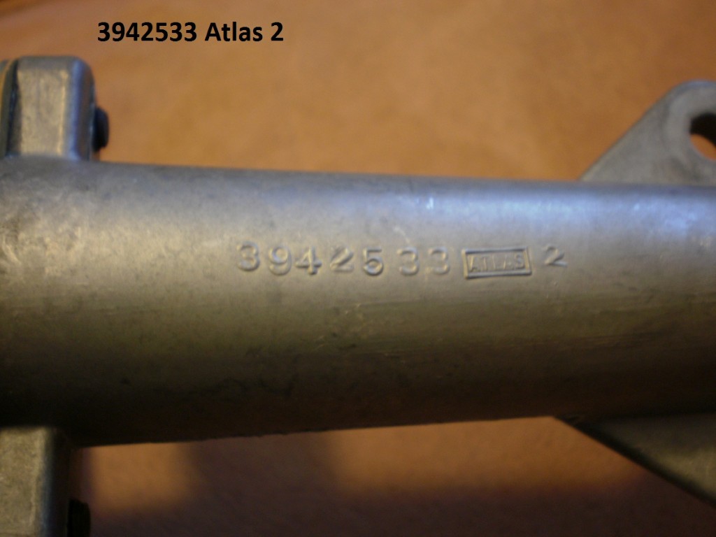

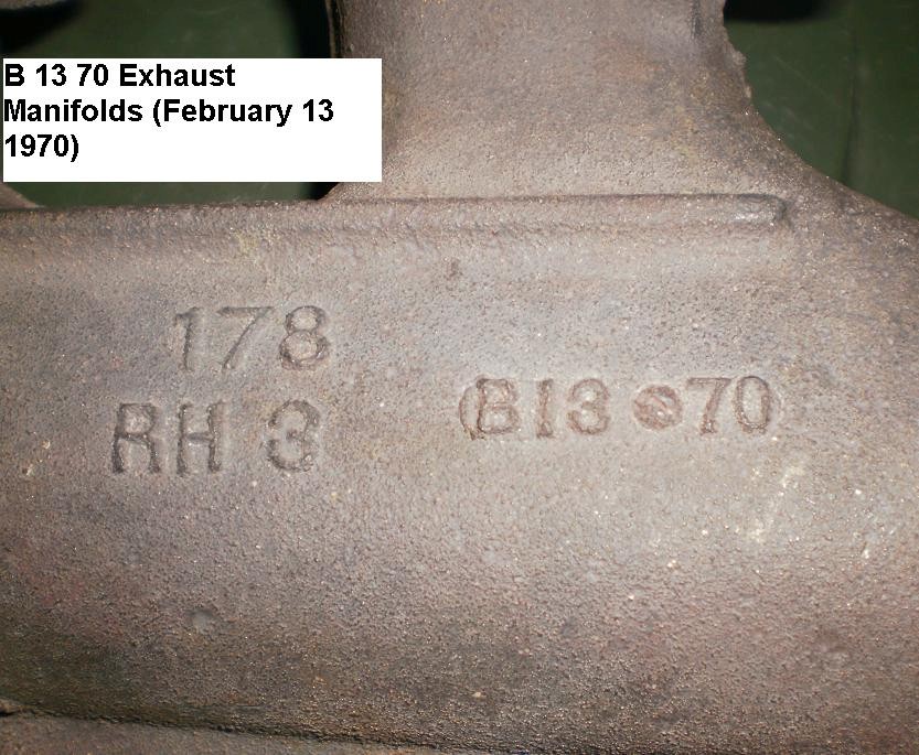

Here is the LS6 Smog with Exhaust manifolds Restored and ready to go.

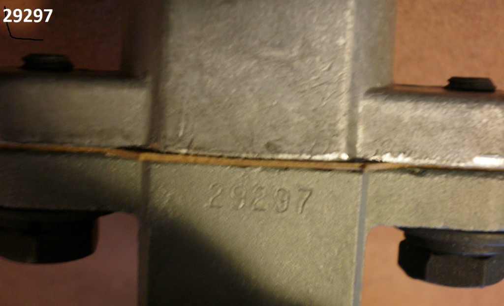

Some numbers i can't figure out?
Also let me know if these are all correct smog parts for the LS6 (Pretty sure they are but i just want to confirm).
All the smog hoses and clamps are the originals.

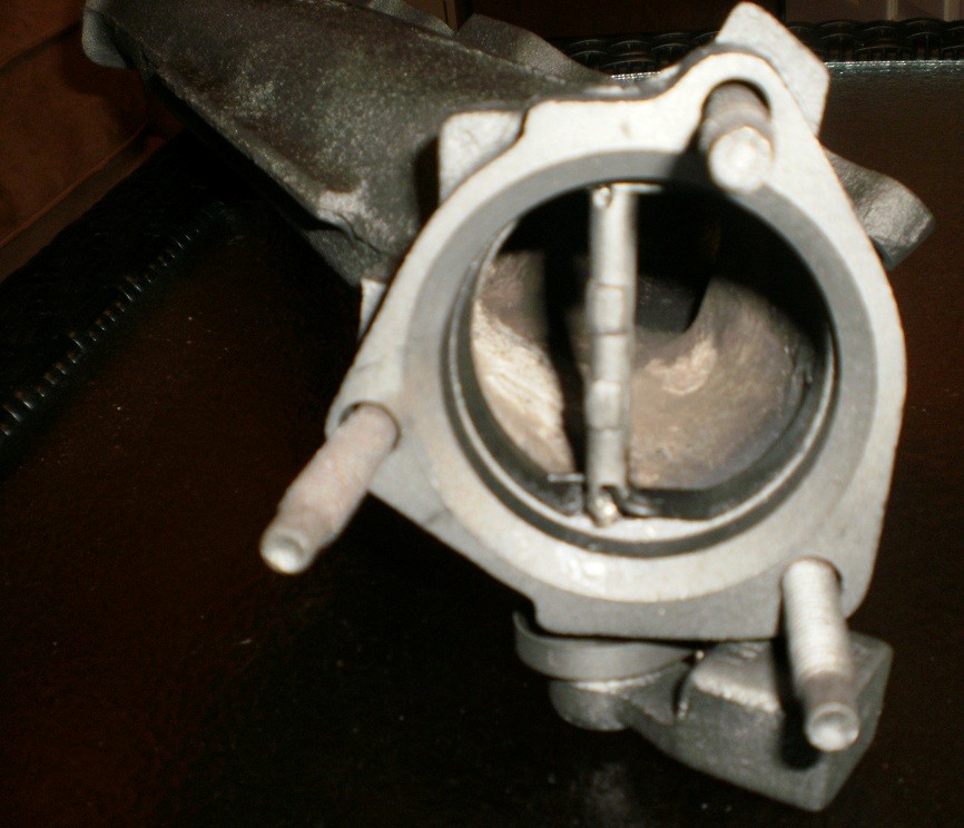

The picture of the Exhauast shows i grinded off the flap, Drilled a small hole and added a cotter pin to keep the side of the bar from sliding, I figured why bother having the heat riser with the flap if the car never gets used on cold days!
The Exhaust heat riser will still operate but with no Flap in the damn way (free flow all the time).

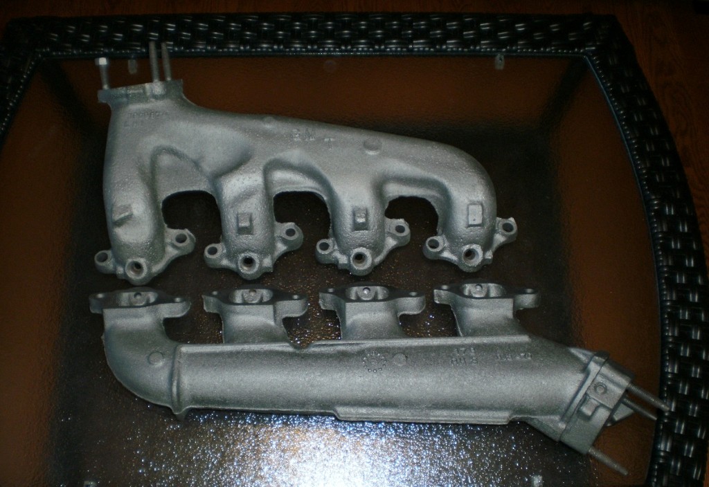

Exhaust Manifolds Bead blasted and VHT baked on the BBQ.
Came out fantastic,you can not scratch this stuff off as it baked right into the pours of the metal.
Both manifolds are dated the same.
Bottom picture was taken before the manifold was blasted and painted,so you can see they were not in bad shape at all.

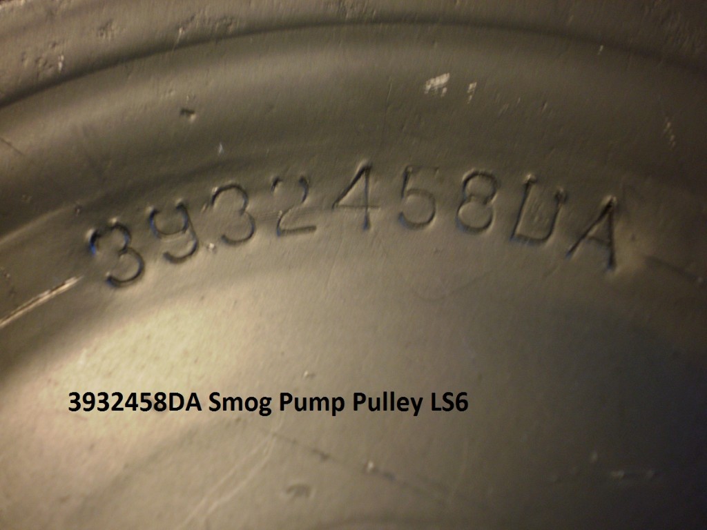

Here is the Smog Pulley

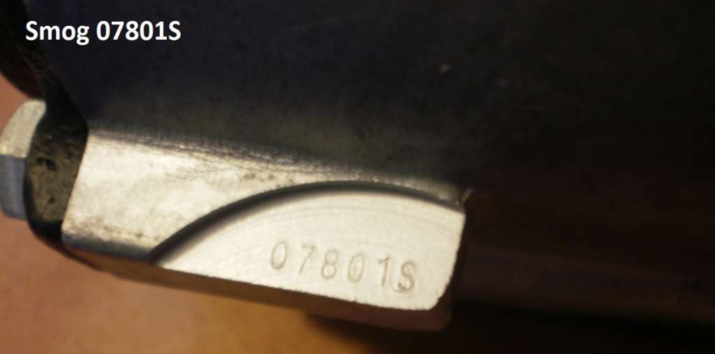

Do you need a white SMOG fan?
Your SMOG Pump shows an assembly date of March 19th,1970.
I know you said you have an April 23rd car,but what's your engines' assembly date?
Old 11-29-2011, 03:31 AM
XXXGoldL34M20's Avatar
Join Date: Dec 2009
Location: Great White North
Posts: 4,082
Thanks: 135
<div class="ubbcode-block"><div class="ubbcode-header">Originally Posted By: Mr70</div><div class="ubbcode-body">Do you need a white SMOG fan?
I know you said you have an April 23rd car,but what's your engines' assembly date? </div></div>
The Fan is white underneath the Pulley, Is that the fan you are talking about? if so i do not need it.
Can you tell me were you got the March 19th date From the smog?
(Which Photo)
Engine assembly date is March 26 On the front of the block and March 5 Casting at the rear of the block.
Old 11-29-2011, 04:07 AM
Posts: 21,022
Thanked 3,743 Times in 1,504 Posts
Yeah..that's the fan.
March 19th comes from your 07801S code on the machined pad.
