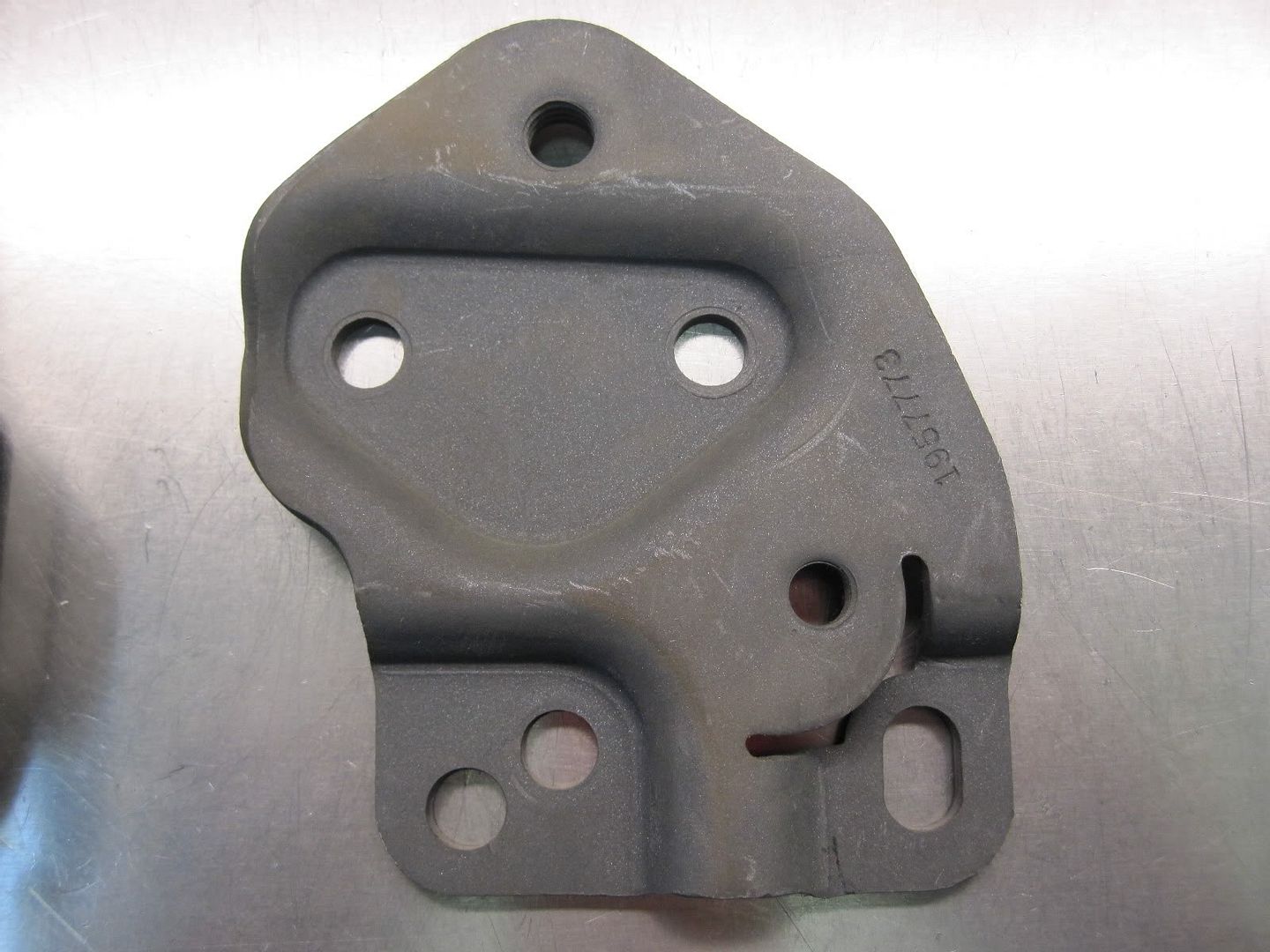

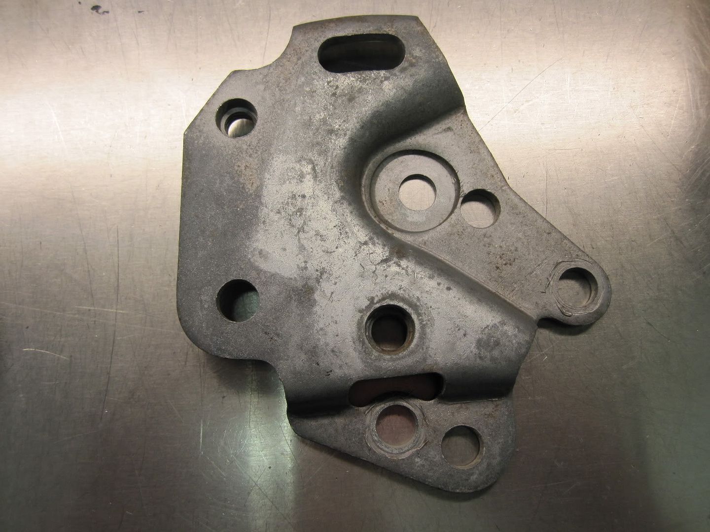

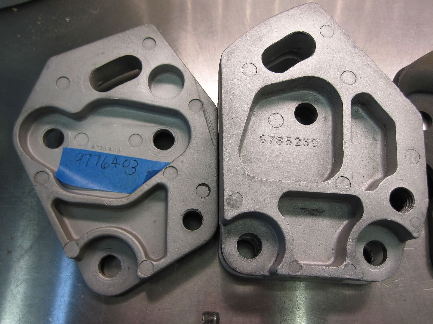

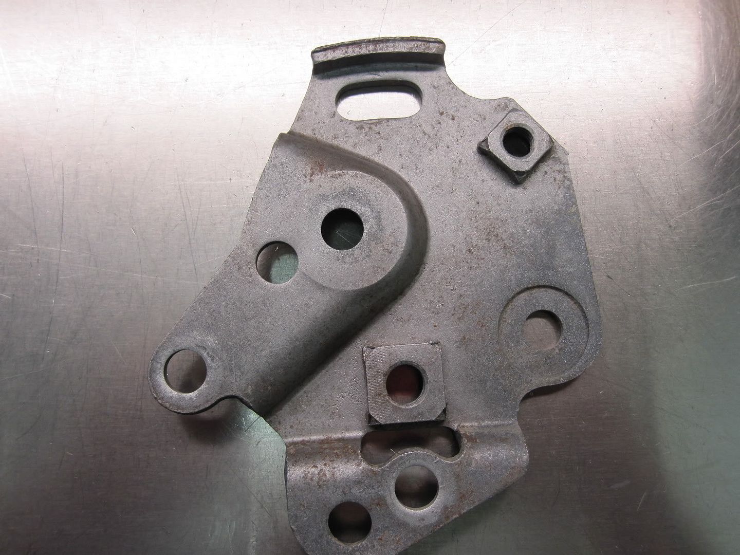

I dug these out of a box I've had in my shed for the past 20-30 years and don't remeber what the applications are for.
any ideas?
This one was on a factory 69 camaro or firebird shifter, since I got this from a pontiac guy I'm thinking firebird?

9776403 is 1964-66 Pontiac A-body
9785269 is 1967-69 Pontiac A-body
1957773 Hurst after market for 1964-72 Chevelle and others
The bottom 1968-69 Firebird, 1969 Camaro S.B.
Hope this helps... Crash
