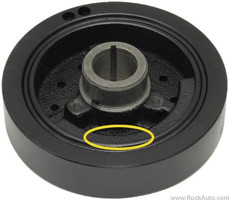

I AM LED TO BELEVE IT IS A 427CU.IN. 425 HP OR A 454 LS-6 460HP WITH A EXTERNIL COUNTER WEIGHT ON THE CRANK. I HAD A METAL URILGIST COME OUT AND HE SAID THE BLOCK HAS BEEN DECK WHERE NO VIN NUMBERS COULD BE RETRIVED. I ALSO WAS TOLD IT COULD BE A 1970 NOVA COPO 427 MOTOR ? I will try to check the stroke bye using a flex tube and measure the stroke to see if it is a 427 or 454. Any sugestions as to try to find out what kind of motor I have would be helpful.I check the crank and it has a externial counter weight on it but could not find a cast number ? IF ANY BODY HAS A SUGESTION WOULD BE GREATFULY HELPFUL. IT HAS A SOLID LIFTER CAME.

I am betting you have yourself a 454 LS6 there, given the 1970 casting dates. There are only two COPO Novas - the 1968 L78 396/375 Automatics, and the 1970 LT-1 Corvette engine cars. That's it. No 454s or 427s factory installed in Novas.
Anything down by the oil filter area in regards to a VIN stamping?

-----you should be easily able to tell if there is a 454 balancer on the crank by feeling for the counterweight on the backside......Bill S

Just feel for the lump
