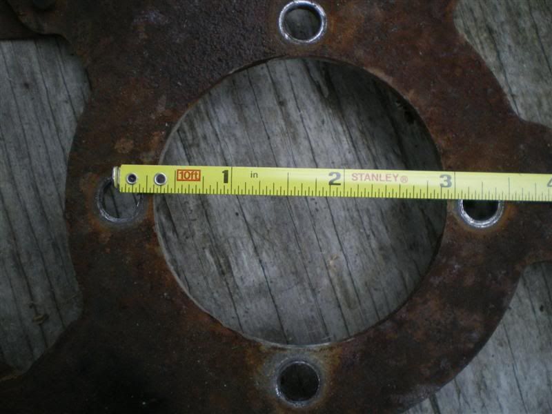

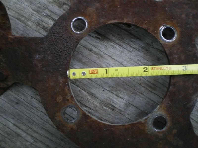

This 5 blade clutch fan was in the trunk of my 68 Custom coupe and I am trying to figure out what it is for. I took some pictures of measurements on it. It has a "W" stamped on the back, and the front has "FRONT" and "H" stamped on it. I believe this clutch is called schwitzer style. I didn't see a stamped code anywhere on it.
![]() ![]() ![]() ![]() I really appreciate the help! Steve

The fan itself is very typical of '59- up but the clutch is a mystery. I have one like that myself.
Verne ![]() |
Looks like all the correct measurements to be one of the hard to find 67-68 Z28 style fans.
4 rivet blades, 3 1/4" bolt centers, 2 /5/8" center hole, and the correct style schwitzer clutch. Cha-ching! ![]() |
Isn't that one of them "junk" 67 Z, L-78 and other square port hipo fans...??? I'll take it off your hands if you need to get rid of it, ok...
![]() Seriously though..didn't Charley sell one of them for $3500 or some ridiculous figure a while back?? |
I think the fan blades with the "W" stamped on it were for Hi-Perf cars with short water pump.
When I had my '68 Nova...I was told me that that was the correct blade for a high horse BB. I could be wrong...it's happened before. Believe it or not! ![]() Kurt

Thanks for the info. Is it possible that this is the original fan from the car (68 L72 Impala)? I always thought this engine used an eight blade..
