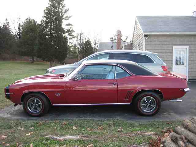

Karen likes Garnet Red
02 Berger 380hp #95
Lots of L78 Novas
Join National Nostalgic Nova!
70 Orange Cooler
69 Camaro
Old 02-04-2009, 06:56 AM
Posts: 32,611
Thanks: 8,092
Default Re: 52 Garnet Red Paint
That Camaro is cool...It'd make a great Members Ride
Old 02-04-2009, 08:09 AM
WILMASBOYL78's Avatar
WILMASBOYL78 WILMASBOYL78 is online now
Location: new york
Posts: 8,423
Thanked 2,308 Times in 613 Posts
OK Bruce...soon as the weather gives us a window...I will get some pics and hook you up.
