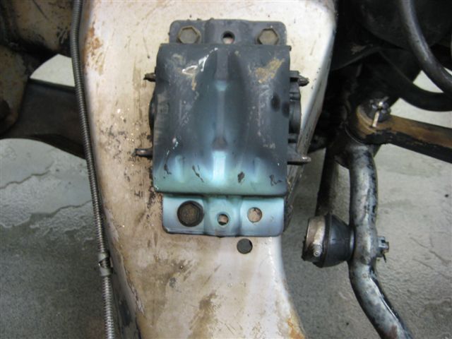

Those Camaro engine mounts do not look right for 74 as advertised. Here is what 74 z/28 engine mounts look like.

He's right Matt.
Your mounts,#890LH & #930RH,were installed on 1970-72 Camaros when equipped w/307 or low horse 350cid. only.Not for Z/28 or Spcl. Hi-perf solid lifter engines.
Anyother engine,or year and it used a different frame side mount altogether.
Still desireable parts.

correct 70-71 Z-28/Big Block Mounts........(Rick P) did the Z-28 mount change to the above 74 style in 73 ????

It looks like the original frame side engine mounts used on Camaros equipped w/LT-1 or 402cid. were #3982307-LH & #3964886-RH during 1970-72 production.
They were both soon superseded by engine mount #332648 what looks like sometime during late 72 early 1973 production,but when exactly I can't say.
