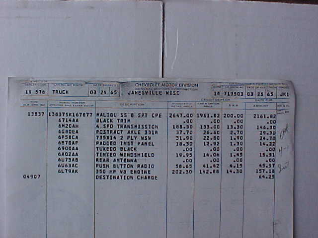

There's a 66 Nova at B-J that is offered as a Nickey Nova....Here are a couple shots of the Original???? Window sticker.......The POP is from another dealer (I think in Michigan...Couldn't read it very well as it is a copy and very Faint)........Let's see if your thoughts match mine... So......what do you see as unusual??

Nickey Perf Prod.? Spec. Ed.? Nickey Performance Pkg. on the window sticker? Huh?

Air conditioning delete, M22 behind a small block, seat belt prices are high,.....

A/C delete? 15 inch wheels? What is the Nickey performance package?

I could believe that it's perhaps a dealership-made window sticker, but no way could I believe that's from the factory

I don't believe that Bill. Always some story on these Nickey cars. Why is the POP from another dealership?

The First day I was there and looked at the Window sticker it was shown in it's full length........showing the final sticker price which was in the $4200 range (Didn't have my camera that day).......as you can see now, they folded the sticker right at the Nickey line.......they must have realized that the $420 A.C. delete was never subtracted.......What a Joke....My SS L-79 Car Stickered for under $3000.........whoever "Made" that window sticker didn't have a "Clue"......Also...Notice how the Delivered Dealer portion of the sticker is conviently missing...

That window sticker is 100% homemade.
It gives itself away in the first 2",and reading further on down just echoes that.

Now why would the window sticker say "optional" 327 350 engine.? Wouldn't it just list the engine with the engine option code.?
