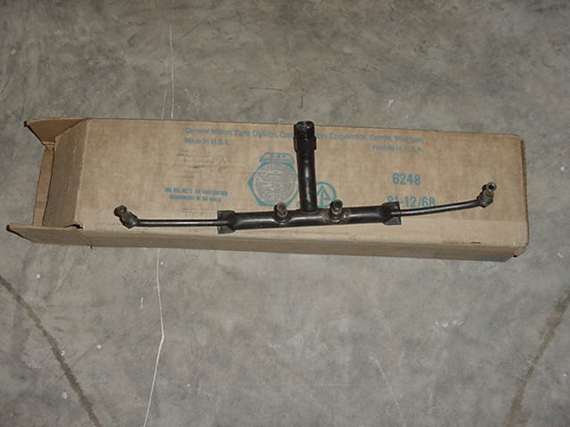

I just listed a right side smog pipe on ebay item # 280292986543 for $9.99 no reserve. This is a very nice item box dated 12/68.
That looks like a 1968 RH side. The 69 would have a 90 degree angle towards the front of the engine where the valve screws on. The one pictured goes straight up.
