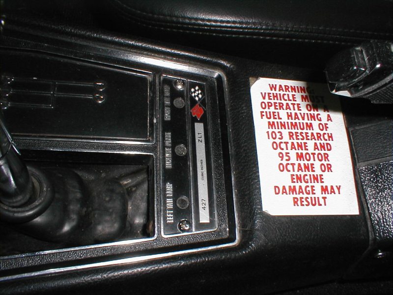

			Well got down to look at the vette...
	![]() Console data plate ![]() Notice the Eckler front end. ![]() 62K miles ![]() 5600 redline? ![]() Engine bay Can someone direct me on where I can decode the trim tag. ![]() Trim Tag Does have rear sway bar, could not see the joints as we spent 20 minutes just getting to the car and to get the door open. Thanks,  |
			Great pics! Good to see you were able to get up close and personal with it. What are you going to do now..buy it and restore it? Apparently it has been a BBC Vette all along. 390 Horse 427. Didn't they option them with Tri-Power or was that the 400 HP 427...hmmmm.  IIRC the 390 was a single carb, iron intake.
