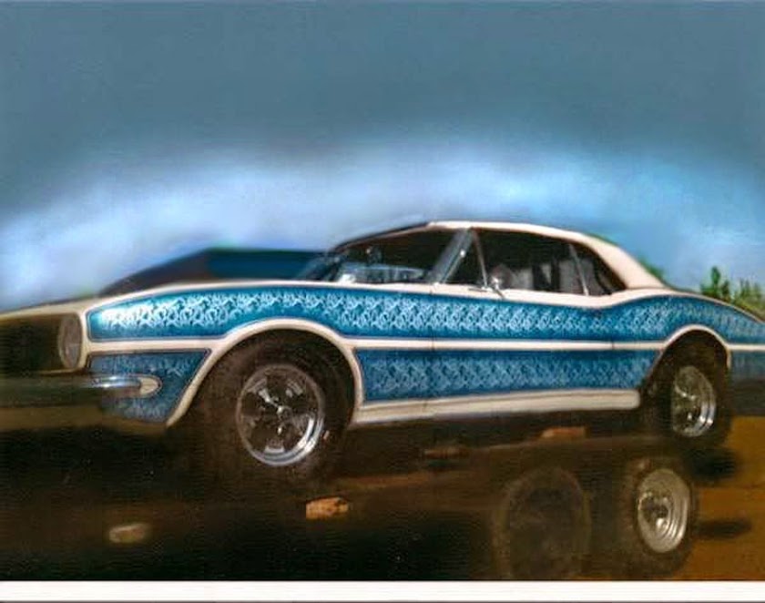

Quain still has the remains of this drag car built and raced in Kansas City and then brought to upstate SC & traded by Jim Little with the blue plexi hood scoop and cage as a drag car to Stott Chevrolet in 1969-1970 - it's a 67 camaro conv SS 396 4 spd.
I have been trying to get him to drag it out and lets figure out where it was sold new and more history for 15 years at least.
