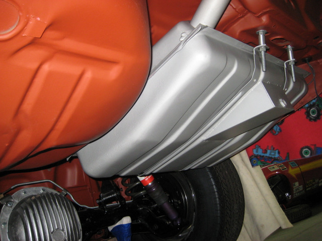

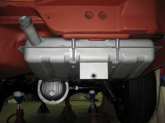

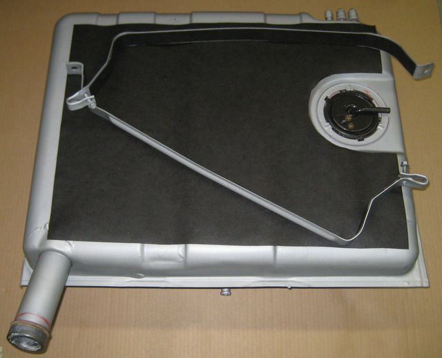

After looking at several gas tanks painted silver, I decided to try something different. After finshing the body work and applying the primer, I painted the tank using Rustoleums silver hammertone. After that, three coats of flat clear finished it off. It's hard to tell in the pictures, but the flat hammer tone has a galvanized look.

I did the exact same thing on some suspension parts and was amazed how well they turned out.The hammer paint kills great!

Nice touch. Looks great!

Wow, that looks nice. Very clean work.

Sharp work Tracy. Never knew the Vegas had the off set gas tank. Probably conducive to a better launch placing more weight over the r/r tire!

Looks like you glued long strips of rubber to the tank straps so as not to chafe the tank. Is that correct?
