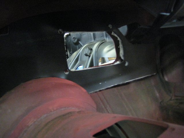

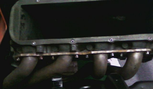

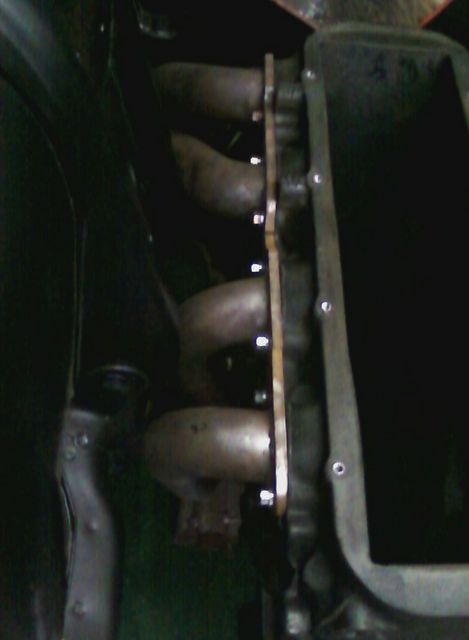

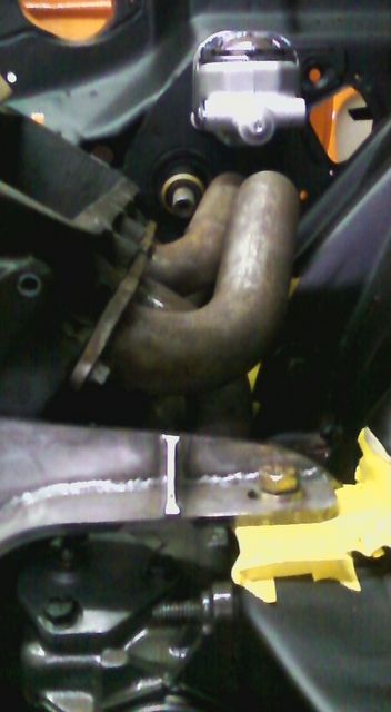

Worked on the car a little and fitted the Motion headers. I'm going to have to do a little tweaking, but overall they fit better than the Hooker headers. They can be installed one tube at a time with the engine bolted in place. This will be nice when it comes time for final assembly. No more having to hold the headers in place while lowering the engine in.
The steering shaft will run through the headers, so there will be no need for three steering joints and running it on the inner wheel house.
Also, I should point out that the Motion headers do not require the two rear tubes on the pass. side to run out through the wheel house, so turning radius will not be affected.
BTW, a while back the question was asked about these being real Motion headers. Looking in my V8 Vega book that Schorr wrote, there is a picture of the driver side header, not installed on the car. It's an exact match to what I have.

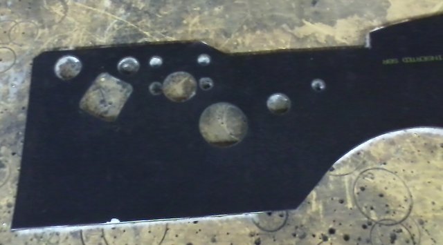

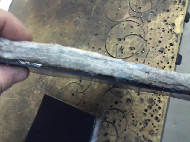

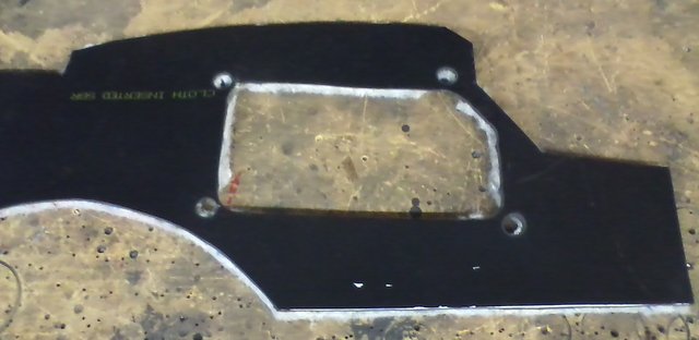

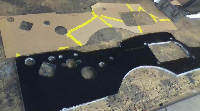

I decided to make my own firewall pad, since there isn't one being offered. It was pretty simple. After making a cardboard pattern of the firewall and all hole locations, it was transfered to a 1/8" thick rubber sheeting. Before cutting the holes out, I used 3M trim glue and attached a piece of 3/8" thick jute material to the back of the rubber sheeting.

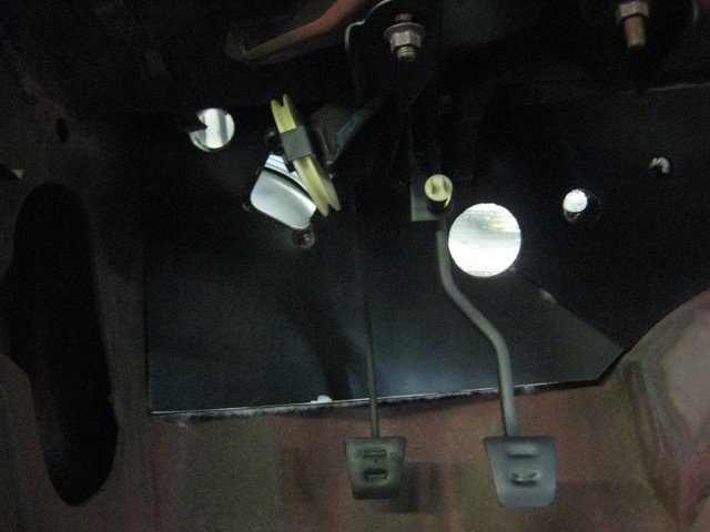

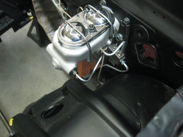

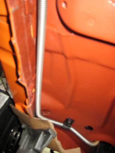

I installed the pad today and all the holes lined up good.

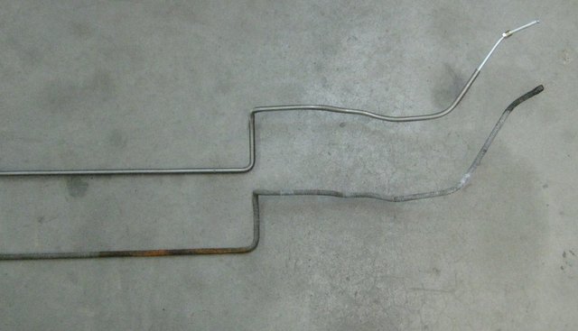

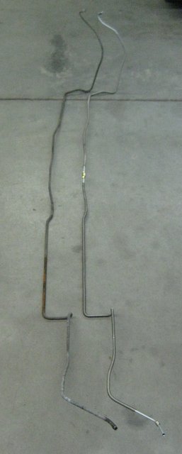

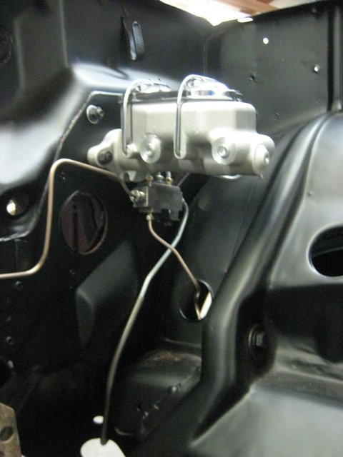

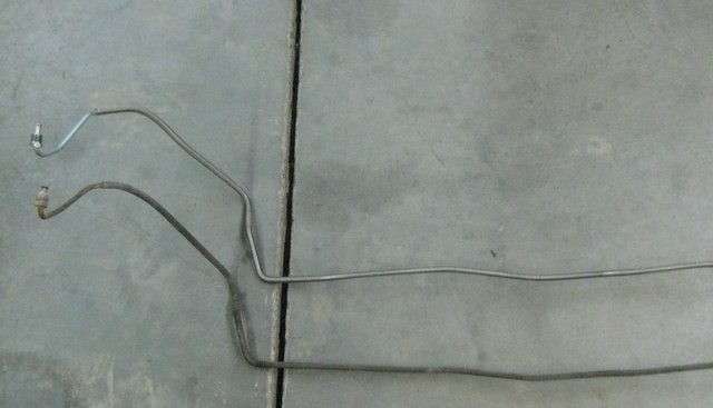

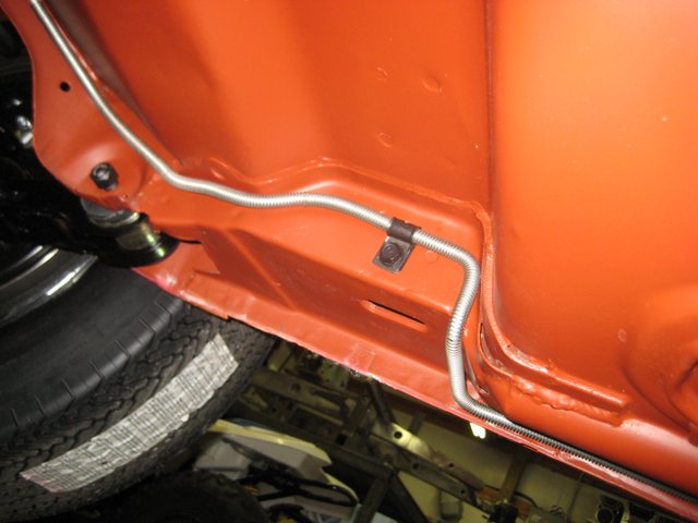

Also duplicated the original brake lines and installed them.
It's not the critic that counts, not the man who points out how the strong man stumbled or whether the doer of deeds could have done them better...
  #296
Old 01-21-2013, 03:30 AM
Hemicolt Hemicolt is offline
Join Date: Nov 2011
Location: East Tennessee
Posts: 966
Thanked 2 Times in 2 Posts
Default Re: Day 2 Vega
Brake lines.

Sharp Tracy!

Great fab work [img]<<GRAEMLIN_URL>>/beers.gif[/img]

Mabe the motion headers should be
Copied ?
How do you like the speedway motors
Master cinder??alumnum looks
Like a good piece .....
