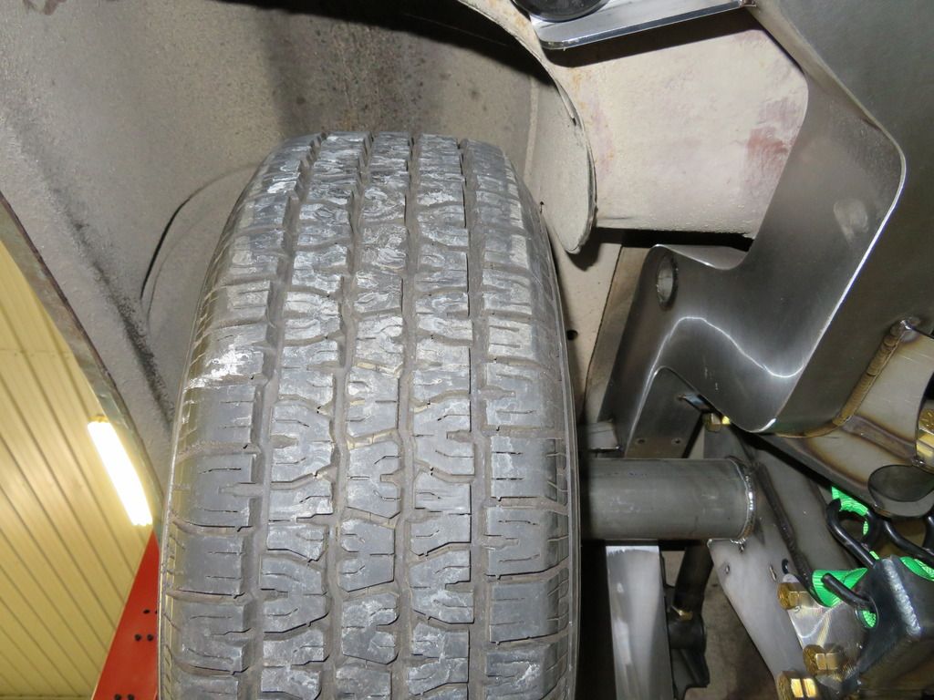

Moving along.............................
Measured up for wheels
Front 18x8
Rear 18x10
Wheel of choice.........................
And now building the exhaust. I wanted the tail pipes to go over the axle. It's going to be tight, but it will fit and work.....
I will be able to fit the tail pipes between the frame rails and the fuel tank to hide them the way I wanted to.

Tailpipes.......................just about finished.

Why is the exhaust rigid welded to the frame? Me thinks that is going to crack the hanger welds after some driving
