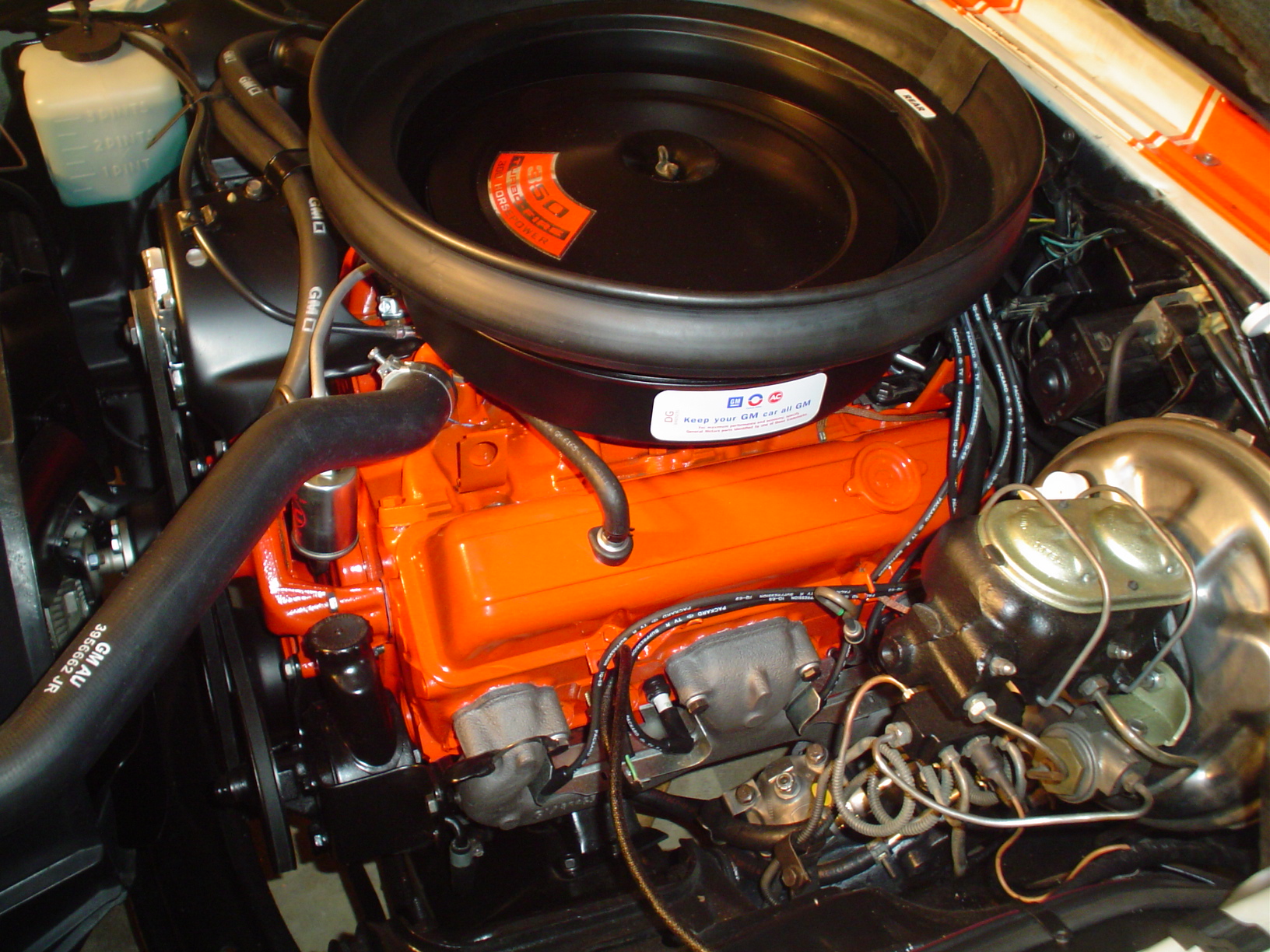

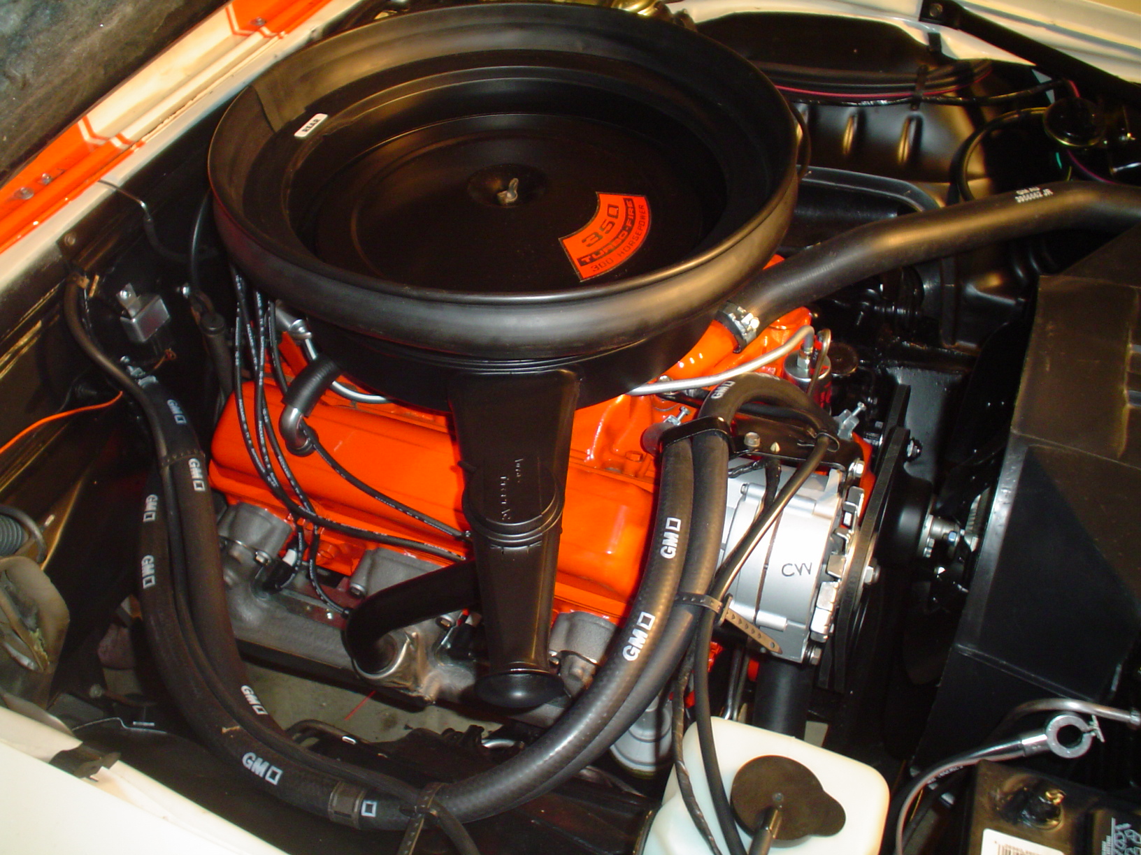

#27
Sal,

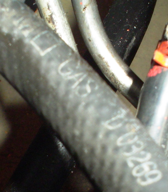

It is pretty much all done.. just waiting for some good weather to break the rebuild in properly. Externally this is 350/300 with TH-350 so the air cleaner is kind of specific to this application with the ThermoAC warm up valve including manifold stove with pipe. Since the car is original and I have owned it for 25 years it still has some very neat untouched original stuff on it... check out the Fuel line to fuel pump hose.. "GM GAS D03369" [img]<<GRAEMLIN_URL>>/beers.gif[/img] This is a driver. |

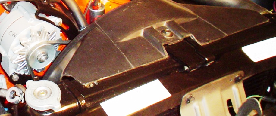

#28
Here is the 21 inch 4 core radiator that I had custom made for this build.. its street manners and overall driveability should improve.
Modifications to the original engine: 186 heads converted to use 2.02 valves Roller rockers L-79 350 HP Cam Keith Black hypereutectic pistons Eagle Rods GM 1187 Steel Crank 302 Z/28 windage tray and Z/28 pan with the internal rails High flow impeller modified water pump Trans input: Hughes 2000 stall converter. |
