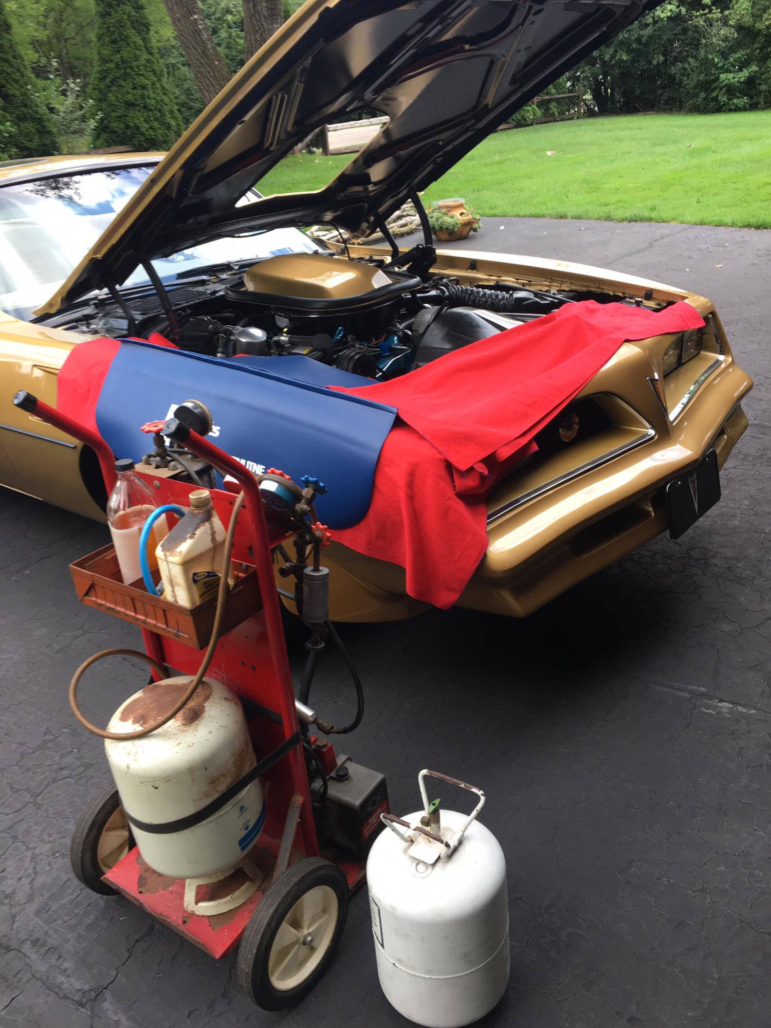

Too bad your not in the D, you could use my equip if if don’t have any
I rescued my R12 system, after being empty for 15-20 years. Got a few stock PCs to put back on one day too.
