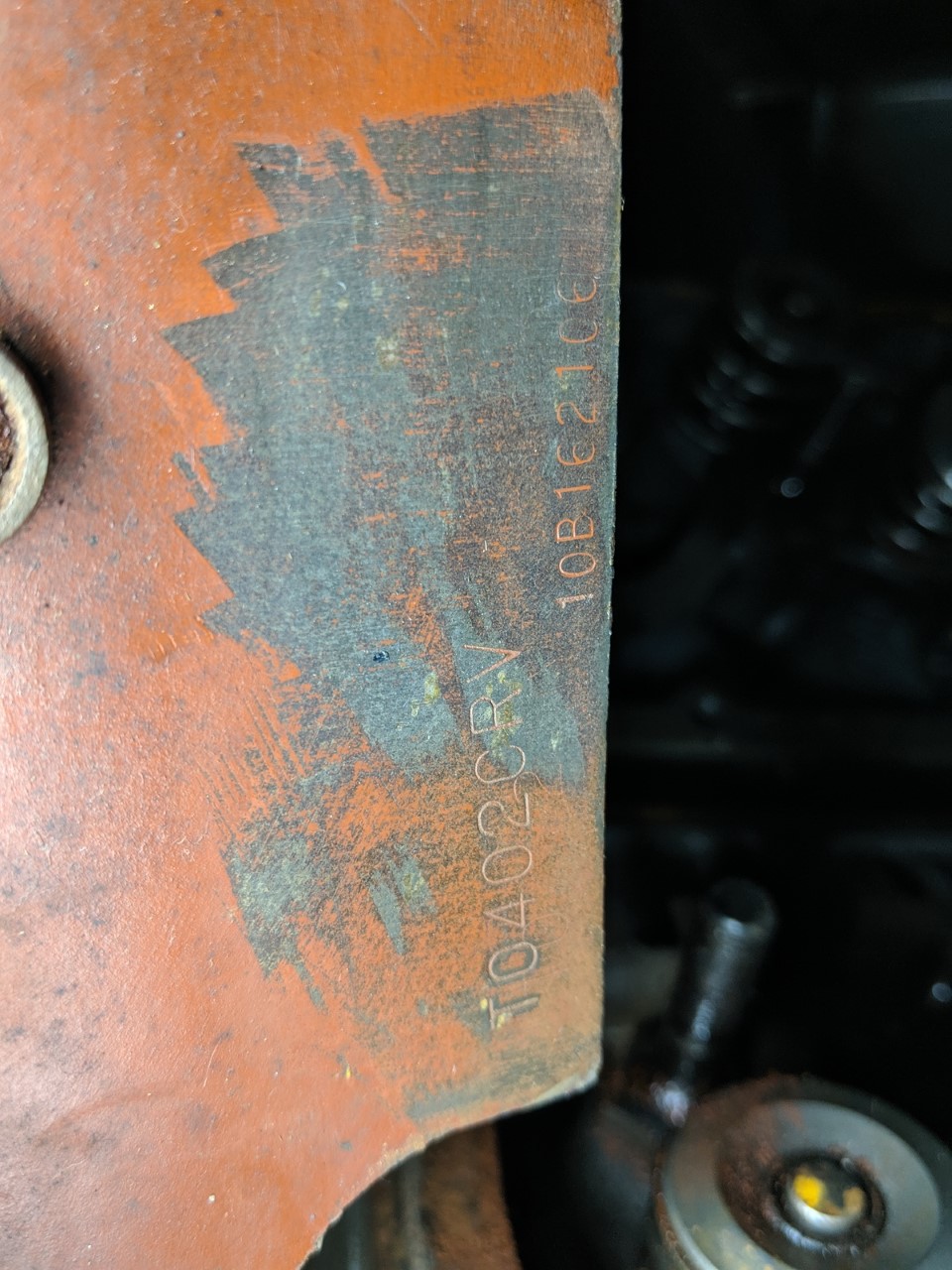

Saw that on FB too - looked like a fair price if it checks out. Had a crappy engine stamp picture, would have liked to see a clearer shot.

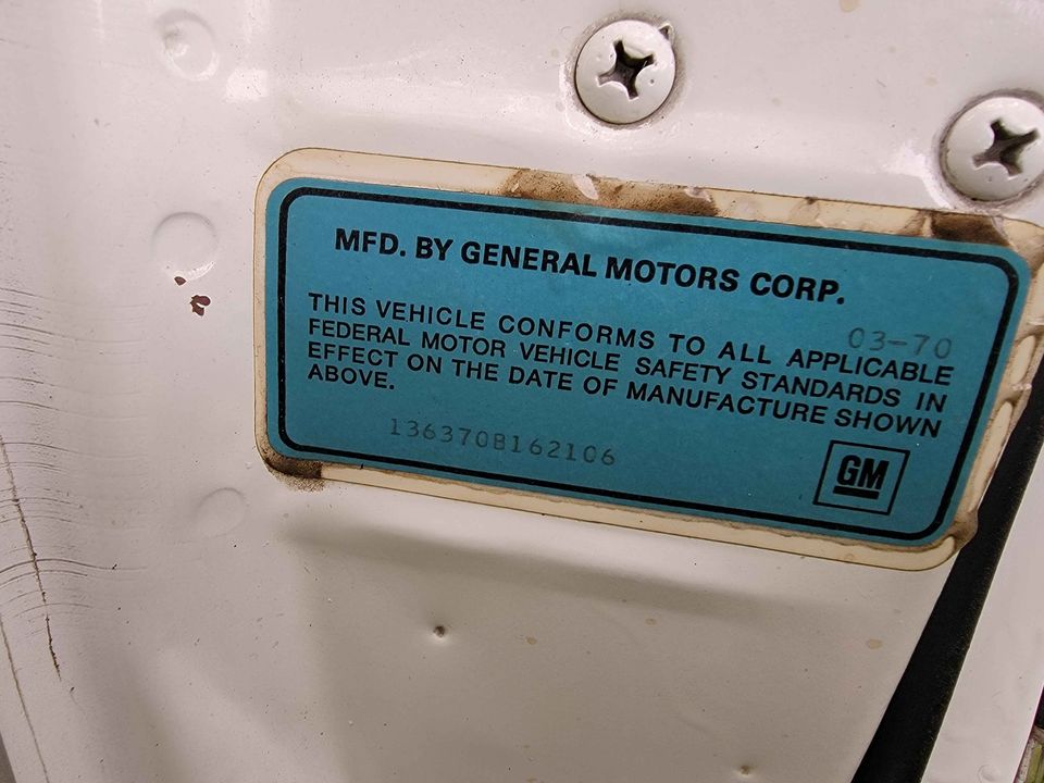

Someone on fb just pointed out car is second week of March built...engine is stamped for april 🤔

Restamp/Deck has been cut
----Just about to say the same thing!....Bill S
Someone decked the block and then restamped it and STILL couldn't get the date right....
