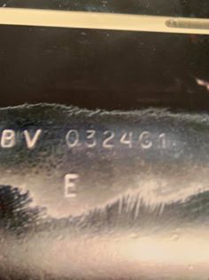

i believe thats an m-22,correct?

Post M-22 trans...
The 'C' is for M-22...the rest of the stamping indicates January 21st, 1969 assembly date. So, does that VIN stamp match the deck stamp on the block and does the date line-up with cowl tag??
Maybe this is an original big block car that someone installed a small block
I would like to see the listing and the photos...
02 Berger 380hp #95
Lots of L78 Novas
Join National Nostalgic Nova!
70 Orange Cooler
69 Camaro
That would explain the trans and rear gear, although the BB engine code would be on the POP (if real)
Maybe a possibility they could order a M22 trans through the dealer request? I have heard of stories like this people asked the dealer if they could add something that was not listed.

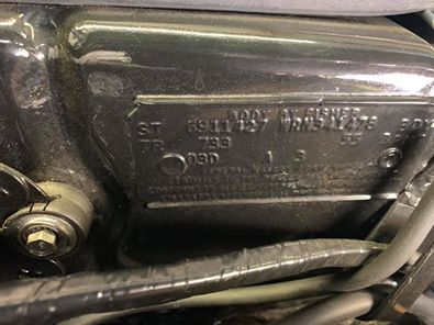

Old 07-25-2019, 09:57 PM
Posts: 21,098
Thanked 3,976 Times in 1,559 Posts
Who's taking these pictures?
Engine pad?

the sellers pictures,a small muscle car dealer in texas.i will give dealers name if anyone wants it,its on a facebook page. says engine numbers correct but wont show pictures of it.does the trim tag look weird too?

Axle in my 03D Z28 is the day after this car
Bill
