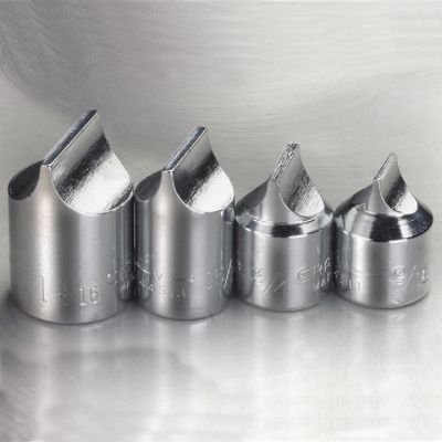

BBB is right,I've used Drag link sockets on those fittings Bill P.

Have to be super patient when removing these. I made this tool out of an old socket, and like many have said, if it doesn't move fairly easy with heat and lube you will remove the threads with the fitting.
Then it's time to fire up the tig welder.
Drilling and fracturing the fitting is usually the safest way for removal.
My homemade so met is awesome for installation of the new fittings.

Chris, that socket you made is absolutely ideal for the purpose! It captures the entire O.D. of the fitting while at the same time engaging the slots for turning purposes.

Nice job Chris. Very similar to my idea but you've made a permanent tool. They should be marketed!

The slot in the fitting in the old water pump measures 1/4&quot; wide....I received the new fitting Thursday and the slot in that measures 0.170&quot; wide [img]<<GRAEMLIN_URL>>/rolleyes.gif[/img] Glad I didn't buy the drag link socket with the *allegedly* 7/32&quot; wide blade (but I guess I'll never know what the width actually is since the seller never did respond to me). So, with Verne's original idea in mind, I went to a local machining &amp; welding shop with the new fitting. Told the owner what I needed to do and he came back with a piece of 3/16&quot; (0.1875&quot flat bar stock about 8&quot; long and suggested that I just file off enough to produce a snug fit in the slot. Sounded good to me so I asked &quot;how much do I owe you?&quot; He said &quot;Merry Christmas&quot;, we shook hands, I went home and filed away and the new fitting is now snugly in place in the newly rebuilt p/n-and-date-correct water pump. The old fitting can just stay in the old p/n-and-date-incorrect water pump.
