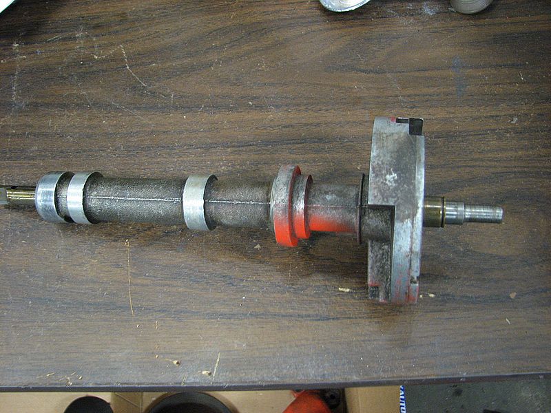

I took an old parts distributor and removed all the guts so I had nothing but a housing and shaft. Take the gear off as well. Insert into the block and attach a 1/2" drill. You have to mill the top of the shaft but that was easy and it works great!
