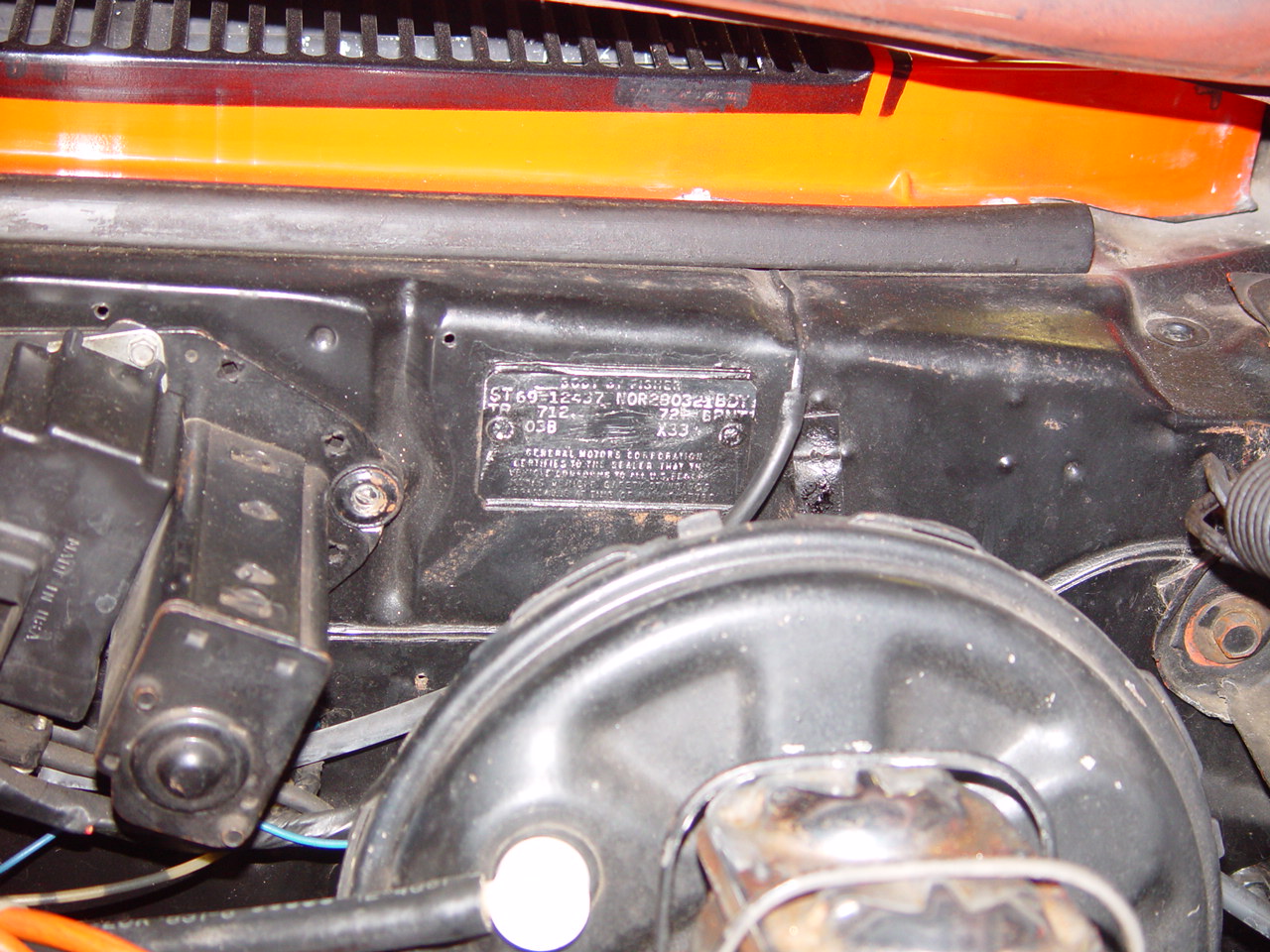

I have to ask about the stripes where they end in the cowl area because I have never seen an original paint 69 Z/28. I saw one picture of the area by the trim tag and I would have thought there would have been more over spray from the body color and the stripe on the firewall area.

The cowl screen was painted off the car. Looks like there was some rattle can touch up by the cowl. There is black paint on the fender reinforcement which should be body color. Maybe when they painted the brake booster!
