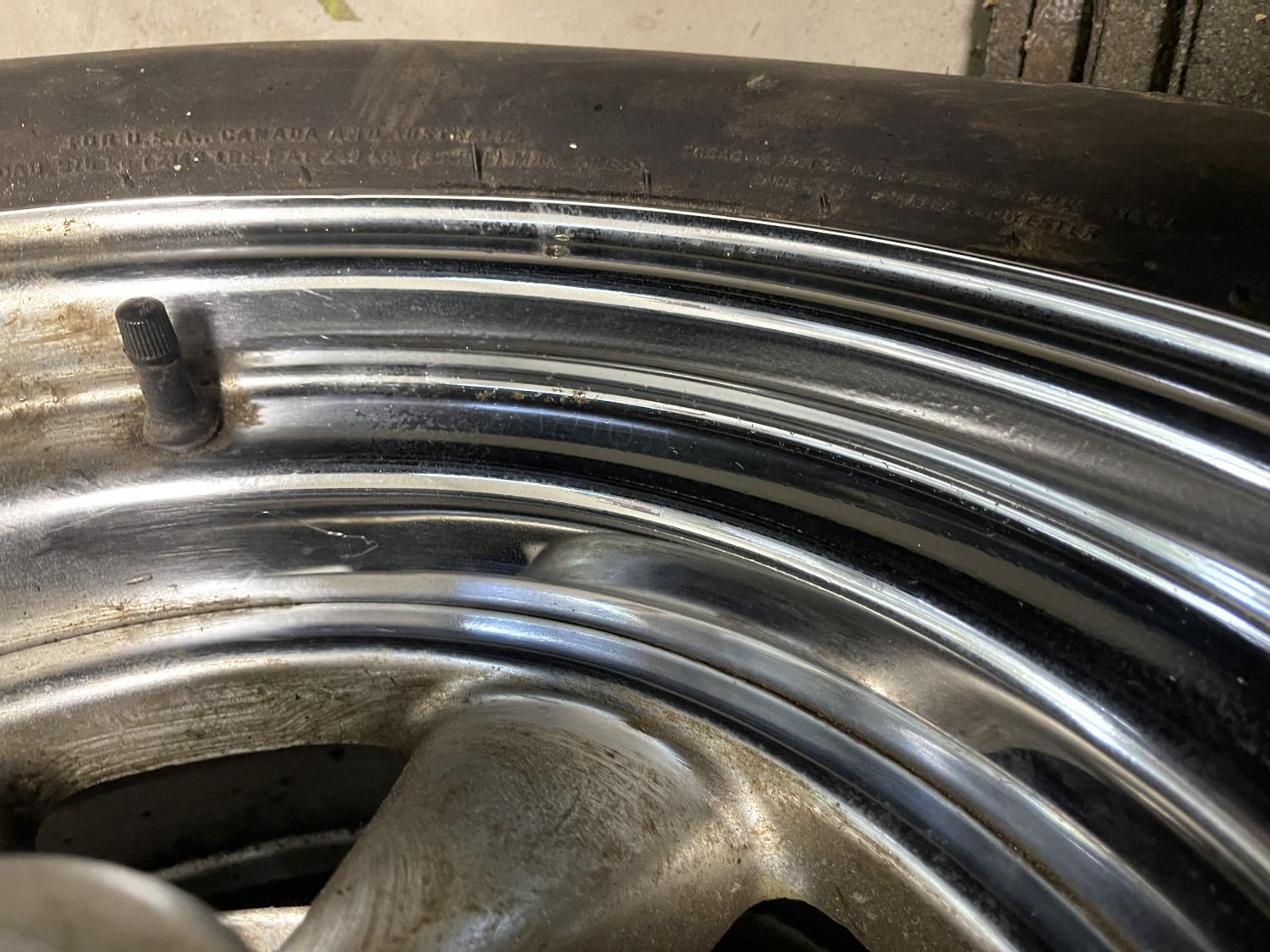

Who knows. Just know while mine are fairly nice they won’t last forever. I try but you know how that goes Mother Nature is trying to break down everything all the time even US .
If anyone has thoughts on how to keep them from getting worse please let me know.
Thought about using this clear in that area just to keep them free of moisture of any kind . Thoughts?

As far as cleaning, WD40 works great. I use a scotch pad that will then be discarded.

I think hitting and wiping them down with WD40 beats any sealer. Moisture can get behind a tiny crack in "sealer". Then it is working backwards from what you want; holding moisture IN.
Once every couple months will do it.

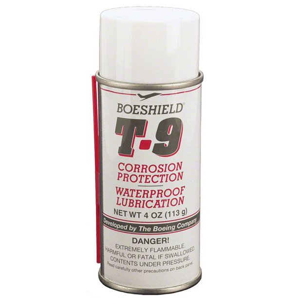

I would use this instead..

I’ve used boeshield on them too I use that on my 300x boat engines but it leave a nasty film I was looking for something I don’t need to clean off that’s permanent preferably. Thought about silver por15 in a rag and wipe it into any pitts good, then wipe it off let whatever is left seal uo the pores in the chrome to make it solid . I have another set I think I’m gonna test that on the other set. Both these ideas posted are good and things I’ve used in the past. But they still get slight pitting in that area. Not bad for at least 35 years on the car. One is perfect like NOS. . It’s just this one giving me headaches
