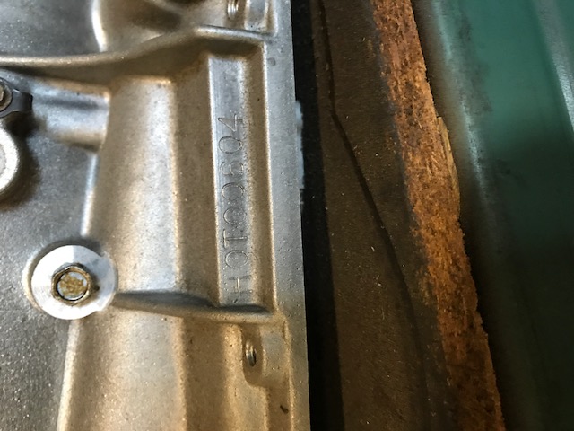

Not to hijack this thread, but I have an N.O.S TH400 Transmission with out a tag on the right side dated 7-69 on the top of the case where it meets the extension housing. It has HOT00604 stamped on the left side above the pan rail where the shift cable would be. Anyone know what this stamp represents? Any help would be appreciated.
Bill

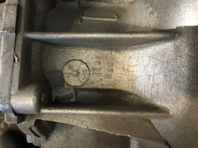

Picture of casting date.
Bill

That's a transmission that was not automatically assigned to a GM vehicle for service at the beginning,as they sold their own product outright too.
It's dated H for Hydra-matic..0 for 1970...T for Transmission...00604 is the serial #.
