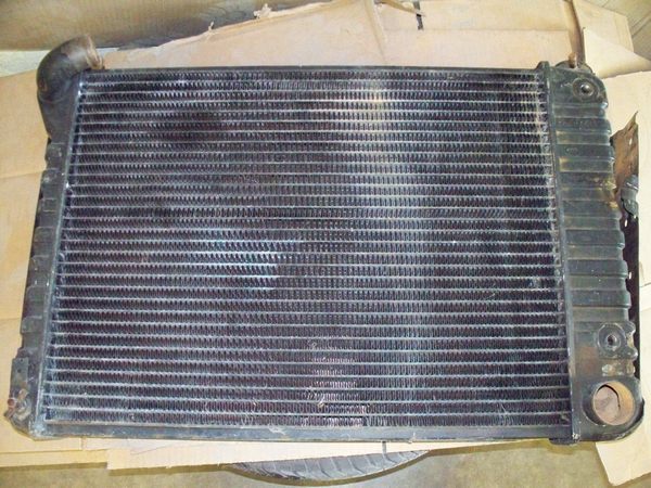

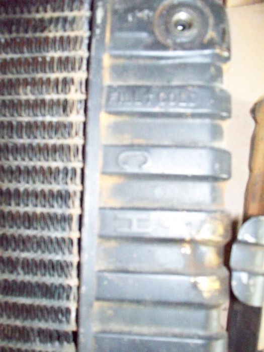

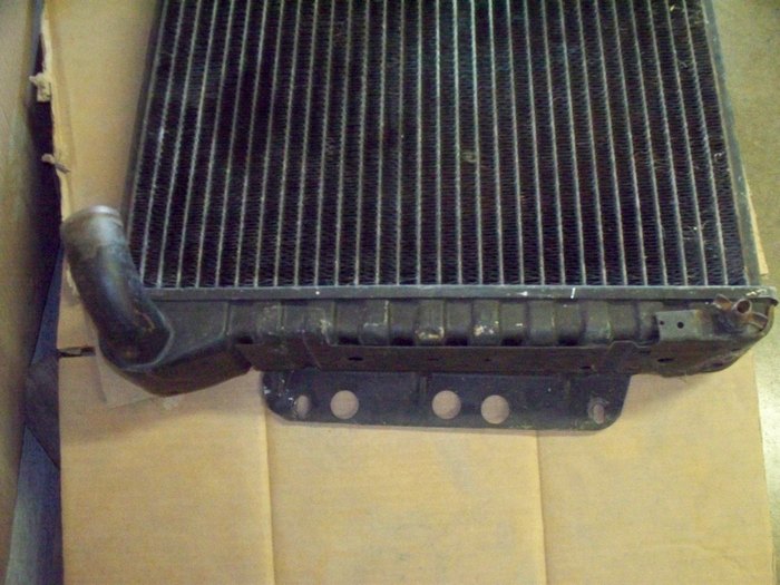

The CH auto on Allen's is a 4 core curved neck.

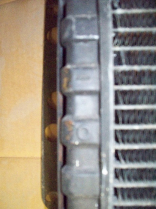

The right tank with the CH is the same for 3 or 4 core...the left tank will be IO on the curved neck application....obviously this is a Camaro radiator since Novas did not get the curved neck model.

i noticed on the crg site that they have noted production exceptions in radiator application and installation on the assembly line... i wonder if that was a possibility on the nova line as well?
