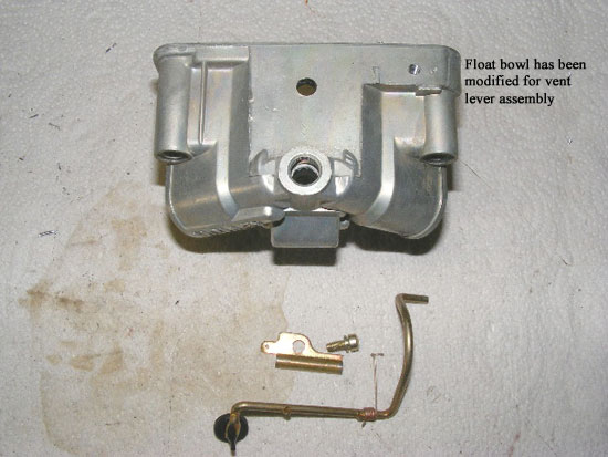

Toms carb was also equipped with an incorrect later-style primary float bowl, which also lacked the correct float bowl vent assembly this particular carb requires. To note; the later style bowls can not be converted to use a bowl vent lever as they lack the cast-in boss for the lever retainer.
Tom provided a correct early style primary bowl, but it wasn't set up for the bowl vent lever either.

Voila...one primary bowl now equipped for a vent assembly.
