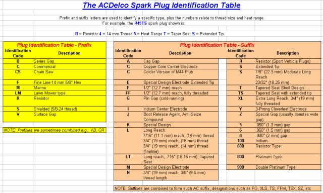

I have a chart somewhere listing the AC spark plug coding. Off the top of my head, the "N" designates a long reach plug. "T" is for taper seat. "S" is for extended tip. There was other stuff as well. Any sparkplug problems that I ever had stemmed from carb problems, carbon tracked distributor caps, or bad plug wires.

The "N" suffix means it's the same 3/4" reach, but only 3/8" threaded, as opposed to the "XL" like the 074 heads got that has 3/4" reach and is fully threaded.
