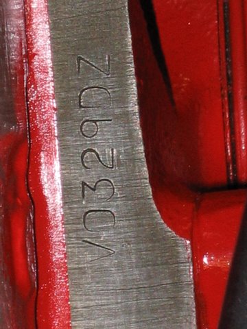

The broach marks on the deck look a little heavy. I would like to hear what some other guys think...
Yep! I'm thinking...36 grit on a belt sander.
Howard
Growing old is a certainty, growing up isn't

They looked a little heavy for me...

The broach marks look home made to me. The front calipers look wrong. As I recall the front JL8 is left and right specific ? As in it only has one boss for the hose to screw into. That one has two bosses, one below the other. Normally there is also a bracket and a short J shaped steel line with spring around it to keep a distance between the hot caliper and the rubber brake line.
[/ QUOTE ] 36 grit on a bent sander at that.

See the difference of the lines that run lenghtwise down the block... on the deck? On the 0329 engine they are not straight nor are they very uniform...
The broach marks are very straight by virtue of the process...

No cowl tag photos... Is it a real Z? What leve l restoration? There are so many different Frame Off levels... what you consider to be Frame Off might not be what others consider to ba a frame off...
There are some obvious problems with broach marks and etc...
If you want to get it verified I would suggest contacting Jerry MacNeish and having the car checked over by him. http://www.z28camaro.com/

Restamp....

Mark thank you for your response, could you please educate me why you think these numbers are restamped? Again thank you for taking the time to assist me.

The broach marks errrr the 36 grit sandpaper marks on the block deck are the giveaway here as to being restamped... People typically dont grind blocks like this... what happens is when a block is milled square at a machine shop they use a cuttting head that leaves radial marks on the block... originally they were broached... there is a thread on this site that shows how large a block broach is... (about the size of a locomotive is how someone described it).
They then cover up the radial marks with either a file or sanding then restamp the numbers they want... If you pulled a head it would in all likelyhood have radial machining marks on the decks where it doesn't show...
