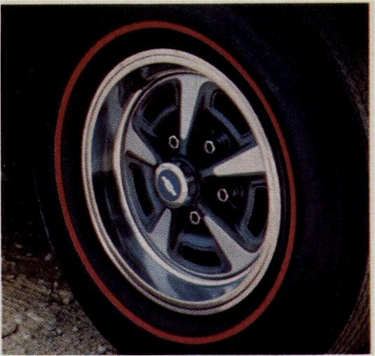

14x7's weren't offered until '69 on any Pontiac. Those appear to be 14x6's and per Paul Zazarine's GTO resto guide, '68 spec Rally II's should be code JA (p/n 9787279) for disc brake apps and code JC (p/n 9789329) for drum brake applications. I wouldn't be surprised if Yenko offered them sans trim rings that year, for the reasons outlined by the other posters.
