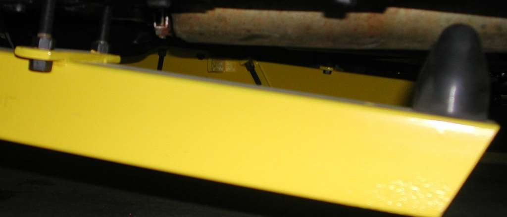

Took some photos of the Lakewood's on our 70 car...
wilma
