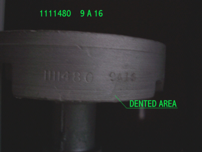

Looks like an early D&R restamp, the spacing is too far apart and the machined lines are gone, take note of the sideways 9. doesn't look good from here !!! Jim
I looked at it earlier and said no Joe don't say anything since you are no expert but this one is so bad it could not even fool me.I'm with you Jim has to be a early attempt.
