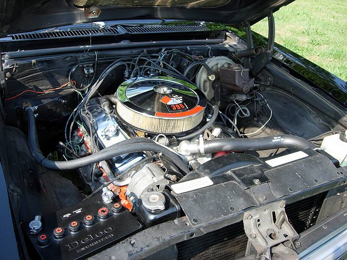

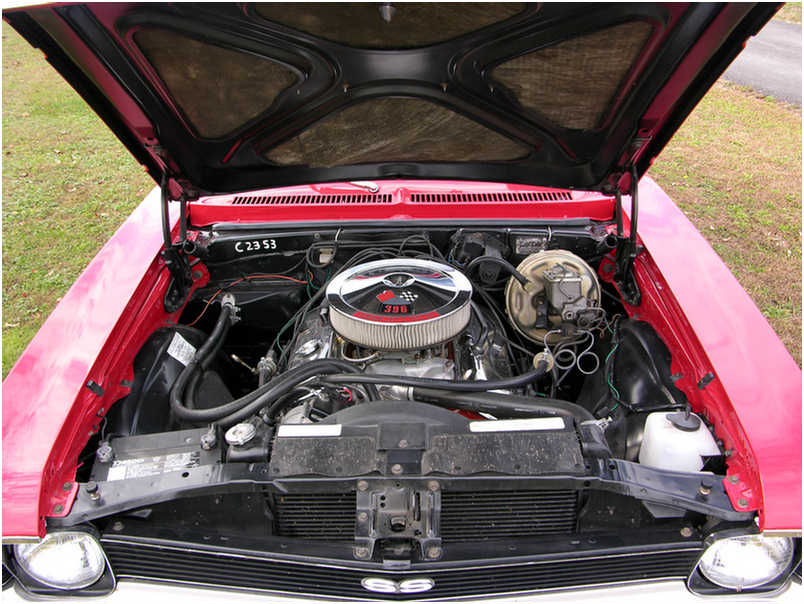

I need the correct metal clips that attach the rubber flap to the rad support for a 70 L78 Nova. WILMASBOY made a post on Steve's nova site about a guy named Benny having them but can not get in touch with him.

Joe, 1970 BB Nova does not use the metal T-clips...the 70 cars used a small plastic "button"....I know you can get these from National Nostalgic Nova. Not sure if they are sold separate or as part of a kit with the flap and bracket...I have got them from Wayne before..give them a call 717-252-4192 or 717-252-2383....tom

Once again, I am amazed at the information one can get from people on this site. Thanks WILMASBOY, I almost pm'd you about this as I was not sure if the 69 & 70 used the same type connector.

It thought the crossover was after the beginning of the '70 year - didn't some early '70 Novas get the metal version?

My 70 (2nd week of Sept build date) had the metal clips, which I replaced with the Plastic ones

My 1970 which was built the 3rd week of 1969 still has the original plastic buttons .Bob
