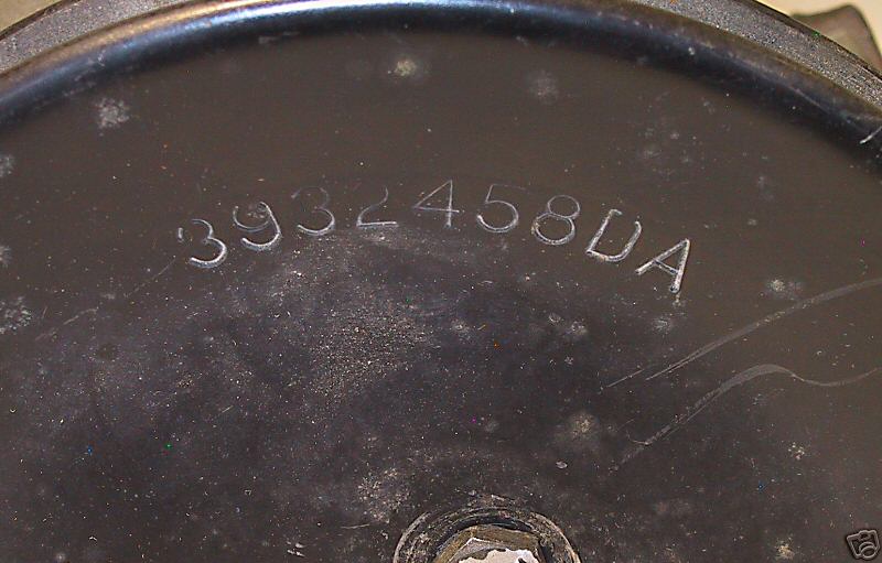

Thanks to everyone for their input, and Mark for his follow-up email. I will take another pic of the pulley when I get home from work tonight. I am obviously not out to deceive anyone here. Thanks - Tony

Here is a old crusty one I have..
Old 10-04-2006, 11:36 PM
Location: Woodland, ca. US
Posts: 16,053
Thanks: 539
Default ebay pulley and my pulley
part #
Old 10-04-2006, 11:38 PM
Posts: 16,053
Thanks: 539
Default Re: Ebay: 3932458 Pulley, NOS 302 Camaro Carb
closer detail

Just got home...I'll be damned if those numbers don't look different than Charley's and Paul's. Can I say conclusively whether this is a really old repro part or a service replacement GM part? I know the guy whose car this came from relatively well, and it's been this way since he bought it in 1994. Thanks again for all the input so far. I'll post the update in the Ebay auction.

Scuncio.. If you stripped the paint off yours we might be able to see it better. I can barely see the ring around your part #. The repos I have seen have had a part # or logo ground off and then filled and painted over.

We stamped a lot of those smog pulleys years ago and sold them (as repro) although it was actually a GM part (Cadillac) that we stamped. Long discontinued, but it was a twin to the original 458 pulley. I'm sure a lot of folks re-sold them as "real" ones. Steve D&R Classic Automotive

I have a few of the Cadillac Deep grove pulleys here.
They are just slightly smaller in diameter then the 458's.
Can't really tell unless they are side by side.
