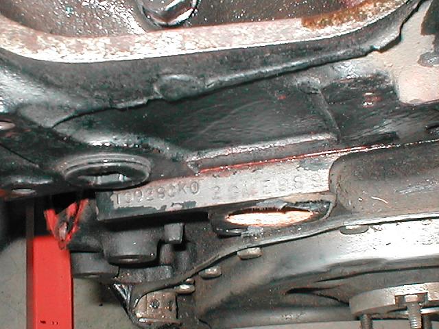

OK, one more time!

I'll be honest with you. It looks like someone went crazy with the stamping. You can see under the CKO stamp another stamping. Very faint but it's there. And what are the other stamps? Is that a GM replacement stamp? I've never seen one like that. Wait maybe I have. I'll think of it.
Are you sure that that is not an original marine engine?

Rick,
You come on a bit strong at times. It has never been stamped or decked before the CKO stamp. The broach marks are still present. The other stamps on the right of the pad are somewhat of a mystery. They read 2GME936. I thought they were from the machine shop that bored the engine but they could also be from the dealer that installed the block. For you to say "someone went crazy with the stamping" is a bit nieve. The "second stamping" you see is a shadow of the original stamping when the stamped bounced. This is a late 396 4 bolt main block with a CKO stamping. Like the late CRR LS6 engines, I imagine this was saved as a generic replacement for L78 engine. I may have also been a marine engine from day one, but the stamp on the pad was NOT added. I can take more pictures if anyone is interested.

Actually Jason I held back quite a bit about that block. The fact of the matter is this. NO CKO was used in 1971 or 1972. Any replacement motor replaced under warranty was stamped "CE" with a corresponding serial number.
You can speculate all you want but I'm not the one being naive.

I've had a gang of parts over the years from the General that you won't read about or find the casting numbers in any book.There's nothing wrong with those stampings,Jason.

If that is the case then someone should be able to produce another example just like Jason's. Anyone?
