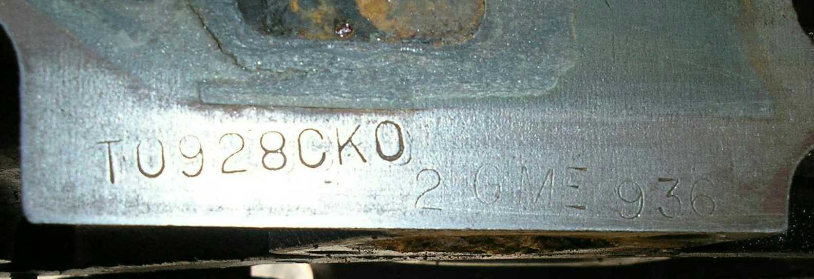

Pics of the engine stamping would go a long way to conclude this discussion. Anything available?

How about this?
Jason

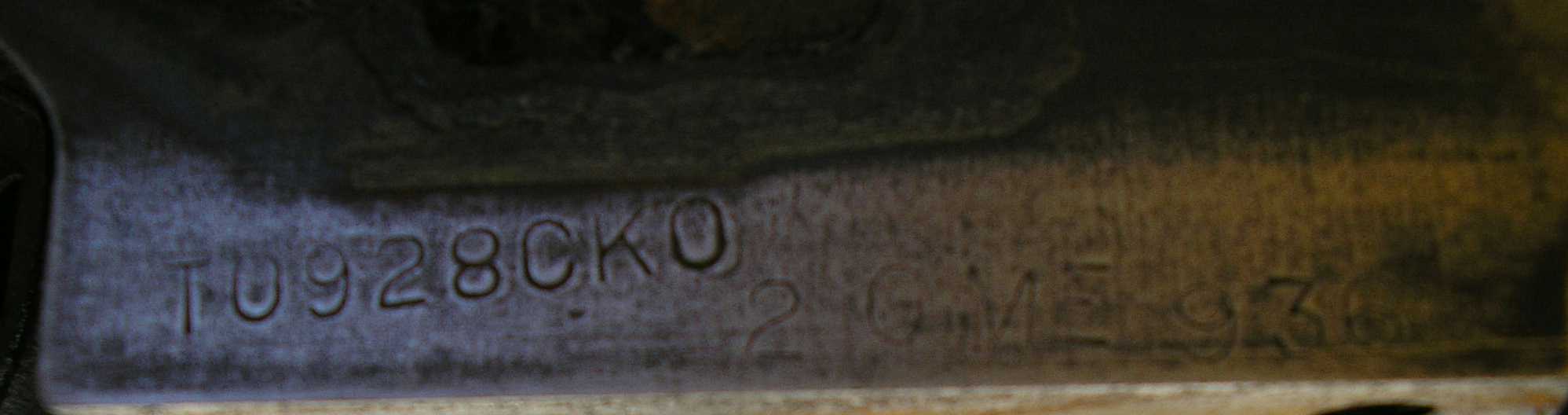

Hmmm.... That came out funny. Let's try another picture.
Jason

OK, one more time!

I'll be honest with you. It looks like someone went crazy with the stamping. You can see under the CKO stamp another stamping. Very faint but it's there. And what are the other stamps? Is that a GM replacement stamp? I've never seen one like that. Wait maybe I have. I'll think of it.
Are you sure that that is not an original marine engine?
Rick H.
