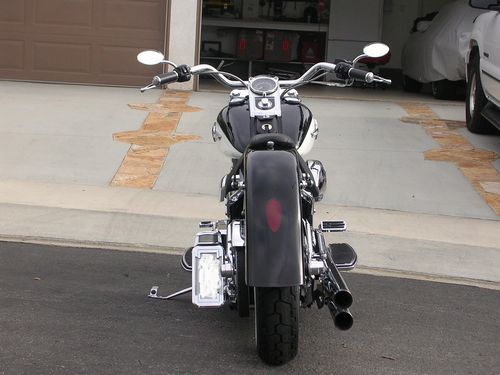

Shaved tailight and sidemount lic plate.
