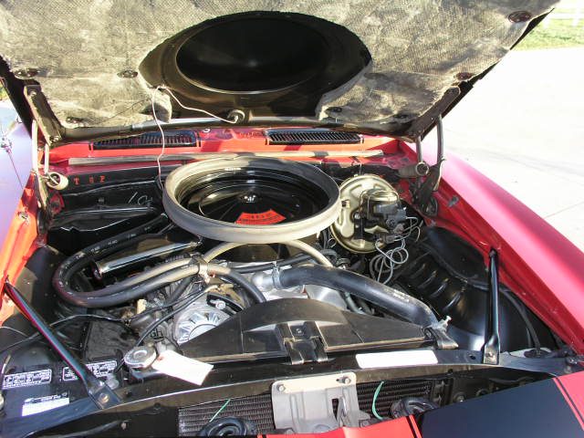

Here is my early Norwood Z with the vin on the pad.
