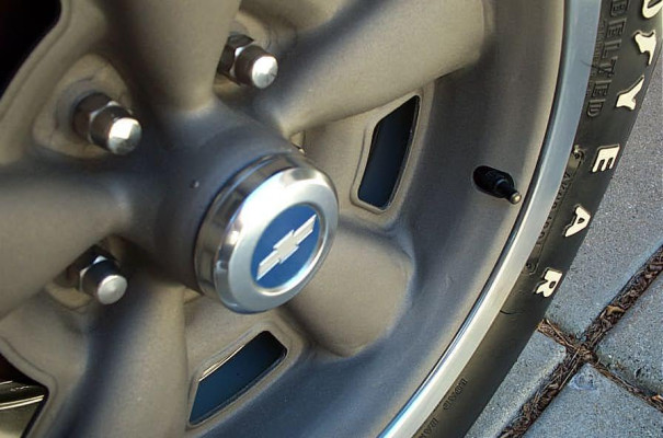

Here are a few pictures of my spare thats never been mounted. It looks a little to gold color but I think that's because the flash went off. The inside if you look close you can see the overspray from the gray paint, showing the gray was painted last and NOT masked. Last pic is one mounted on the car note the correct lug nuts, embossed center cap, 5/8" valve stem hole (70 only up till about may, june) and valve stem extension and original tire.
