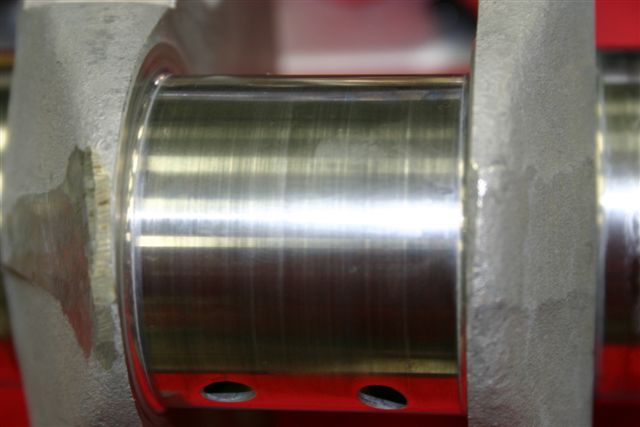

What is that groove cut in the cylinder and block ?

Clearance notch for the rotating rod cap is my understanding. Similar to strokin' a hemi engine block...

On the pan rail; That's for a stroker crank that puts the rod bolt ends out farther...so as to clear with the bigger stroke.

Now I get it...I saw the notch but you had posted "Not a good sign" so it threw me off. Now looking closer I can see where the rod was hitting it...Must of made alot of racket.

seemed to get louder at higher RPMs

I have heard about the same problems with the Mopar Performance Hemi crate engines. I wonder if the same company is building those? Many buyers have installed them and then had them spin bearings, throw rods, etc., on start up. The unofficial advice out in the field is to disassemble them upon delivery, check everything twice and then reassemble and install.

crank lobe meets pan windage

How big is the crank??
