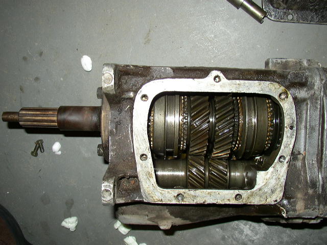

3950318

Input shaft and gears of trans in question....no grooves on input shaft and looks like M21/M20 gear cut.
