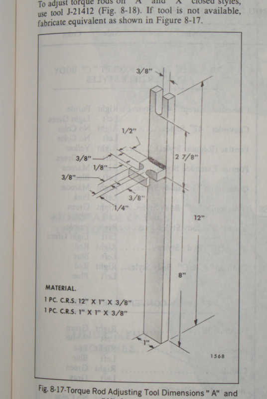

Have a pair of these rods that I took off a wrecked 69 SS Camaro years ago. Don't know if the car had a factory rear spoiler or not - the trunk lid was gone when I got to it.
Anyone know the difference between factory installed spoiler rods and those without?
Thanks for any help Gents.
