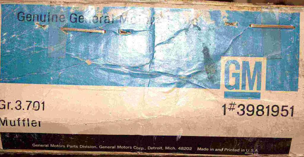

I have one of the 3981951 mufflers dated 9 23 70. Date and part number is on the box. No part number on the muffler, although there are some numbers stamped on one of the outlet pipes.
Anyone know the difference between the 3961396 and the 3981951 muffler. I know when there is a part number change there is usually some change to the part.

Will post a few pics of the muffler I am talking about.
Here is the box.
Lynn
