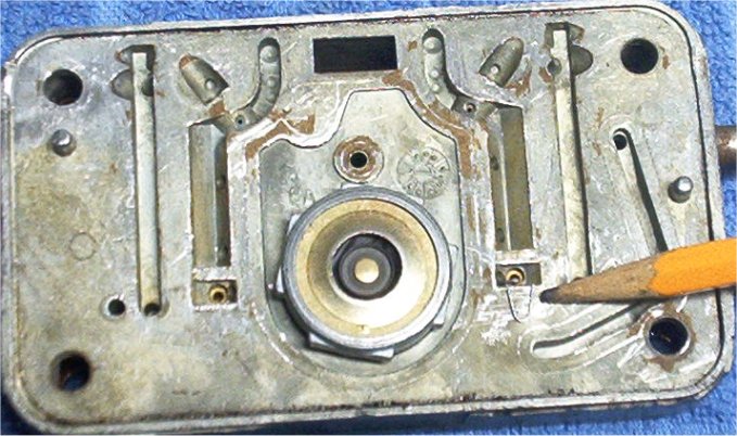

To clarify the liquid line mod, it is not changine the fuel pressure to the carbs, but restricting the fuel flow through the metering block circuits. If you remove your front fuel bowl and then take the metering block out and look on the back side that faces the carb body you will see the liquid line. It can eaily be identified by the only pair of small circuits (holes) which are side by side. One pair on the right and one on the left. It is towards the bottom of the block.

hey Plowman can you show me a pic of how you like to restrict the fuel on the block...it makes perfect sense this is why we have such a hard time with these at idle on the street...whitetop I kinda figured you were going to say that about the matched carbs..."and this complete set-up comes with our special matched tunnel-ram holleys".. remind me to take summit off the christmas card list for next year...

I'm going to try to get a picture up to show the restriction. I enjoyed the picture you posted.

Here is a pic of a metering block. I tried to show the liquid line restricted. You can see a non restricted line on the other side of the block. The pencil is pointing to the restricted line. I used a an 0.018" steel wire and bend it in a "U" shape so that it fits in both ports. It is retained by the metering block flat gasket.
I get the wire from just about any parts tag, they all seem to use this wire and are readily available in most shops. If you can change a powervalve, you can do this mod.
This shows the wire installed in the two holes the pencil is pointing to as well as another similar wire not installed.
