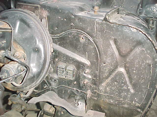

Is this what you are talking about? Mine is march '69 L-78.

Nope.... look on the outside of the sub-frame under the driver's door to see if there is a brake junction block mounted there.

My 68 RS has it under the drivers door on the rail;
Heres a link to the CRG info Topic on it and a diagram on location
http://www.camaros.org/TopicsofResea...ResearchTopics

the man said on the phone this car has that valve he also said it has yellow marking on the firewall that he thinks say gg bb

I researched this the year before last with several of the folks who responded here already. The conclusion was to compare cars to the following hypothesis:
Disc Brake valve is:
1 - near the master cylinder in 1969.
2 - on the frame rail on 1969 built 1970 Model Novas.
3 - back at the master cylinder for 1970 built 1970 Model Novas.
If anyone has a Nova that does not follow this please contact me (JRSully send me an email with a picture if you can) so that I can focus on that time frame.

My 70 L78 has it tucked under the master,and my untouched 69 L78 has it on the frame rail. SULLY
This is what got me thinkin again Gregg, I thought no '69's got it on the rail but maybe Sully's did?

Build date on Benny's is O6A.

I was incorrect, I checked my 69 L78 car car today, it has the brake valve (looks like a solid shot glass) UNDER THE MASTER, not under the frame rail as originally thought, my build date is 04C, sorry for the misinformation. SULLY

I did (except the black 4 speed)
They all have the valve under the MC.
