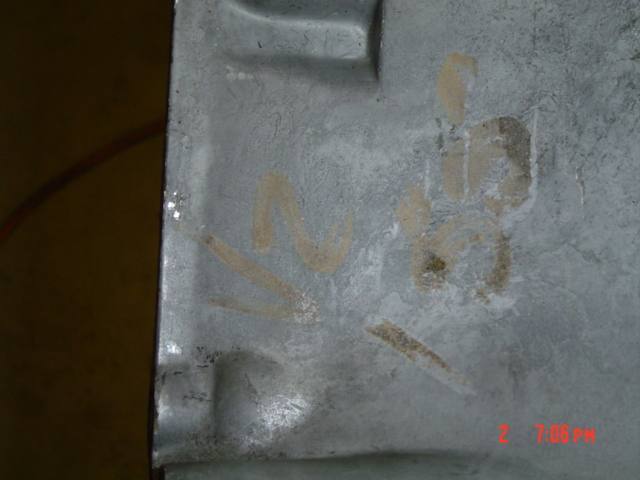

Nice find on the KAN VIN CX!

I second that!! I have never come across a CY or CX tans in the last 20 years and certainly never seen one in that nice a condition. Congrats on the find. Hopefully you did not have to forfeit an member of your body to get it.

<div class="ubbcode-block"><div class="ubbcode-header">Originally Posted By: SS427</div><div class="ubbcode-body">I second that!! I have never come across a CY or CX tans in the last 20 years and certainly never seen one in that nice a condition. Congrats on the find. Hopefully you did not have to forfeit an member of your body to get it. </div></div>
In the PNW a ORIG owner sale on a 50kmile CX is $700 for the core. Stuck in a ORIG owners garage floor and advertised on a piece of cardboard at a swap meet, He knew it was special He was a retired service mechanic from Camas CHEVROLET in Vancouver WA. Not sure how I did but it does not matter I purchased it to USE &amp; ABUSE(enjoy) it (Joking)It sure likes to wind up. Silly me it is behind a L35 and a obvious missmatch. Found a CE 1967 cast L78 (From ID.) to be built at a latter date to power the 68 sometime soon.
