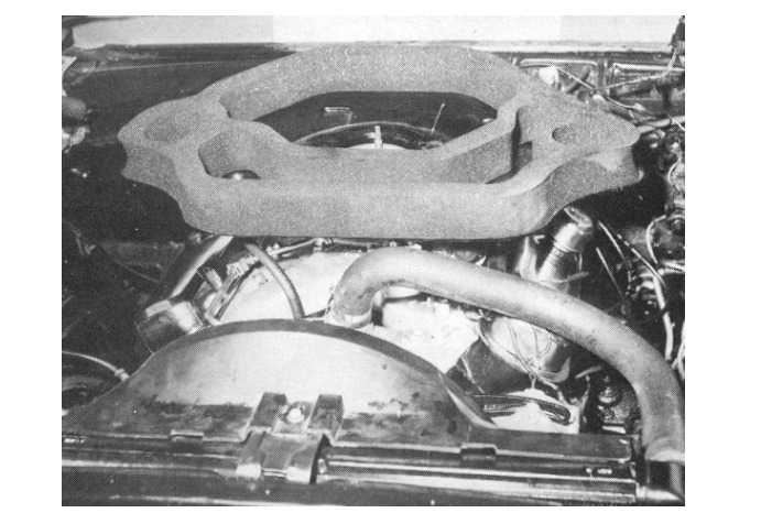

This is the engine bay of a 69 RAV (400) Firebird as prepped by Royal Pontiac.

RA IV lower pan and no power steering cooler?

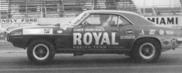

Having some fun with 11 second Bird.

Yep, strange looking, isn't it? This was the Royal Pontiac 350 F/S car that Royal prepped and ran using the 350 H.O., then later used the same car to test a RAV 400. The car has double hood tach nacelles too.
With the RAV, it ended up running 11.65 at 121 mph, and it was a tired test engine.
