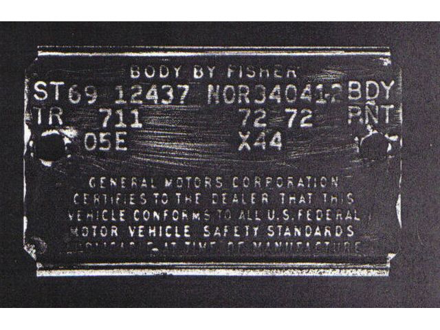

Below pic is TRIM TAG......which seller says was removed and replaced as a result of restoration....any "EXPERT" opinions on how much water this will hold......
Also if ALL 69 COPO's received BE Heavy Duty 4:10 axle's , how can this cars BV standard duty 4:10 diff be explained???

There is a difference between 'removed and reinstalled' and 'removed and replaced'. This one is the latter, IMO.

Maybe I am wrong but those numbers just look to crisp. Also the fold in the top and bottom of the tag are very straight. Originals appear more rounded. Look at an original.

I somehow don't see a brand new, shiny trim tag being a good sign.

Did you by chance, check the DATE of the rearend?
...Does it fall in line with the Date the car was built?

There are companys that provide "replacement" trim tags. I'm sure most people on this board know that, but some may not.
http://www.trimtags.com/faq.html

It's on ebay. And here is it's newest trim tag.
Looks better than the last one....
